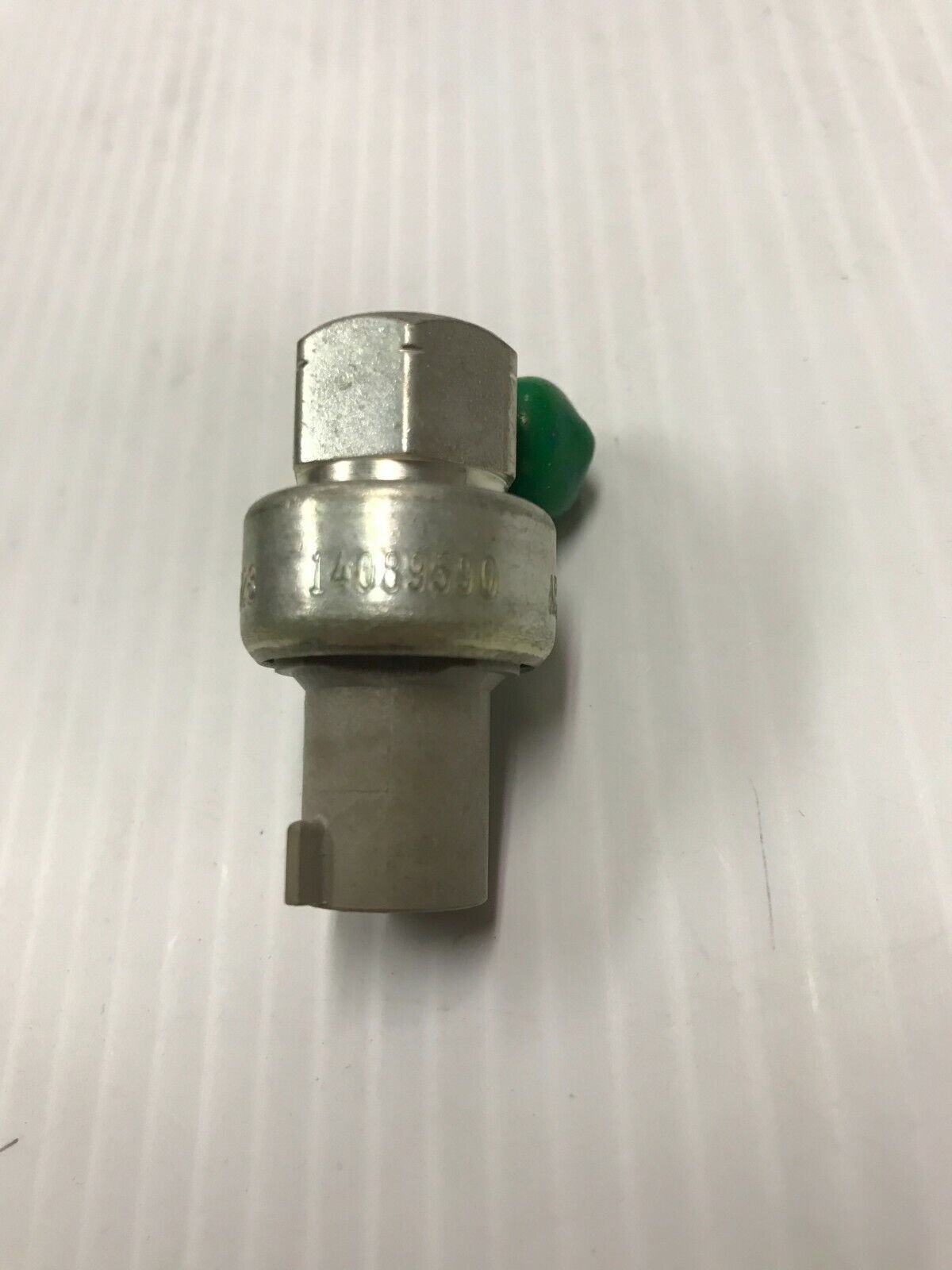

Anyone Know of an alternative A/C fan pressure switch?
Hey! Any help or input would be much appreciated. so Ive searched the entire website and I have a question that no one else has asked. I need to replace my A/C fan control pressure switch, engine cooling pressure switch, or condenser fan switch, whatever you want to call it. GM part # is 14089590 , ACDelco PN # is 15-2517. There is ONE available across the internet for $148 + $12 shipping on ebay ( https://www.ebay.com/itm/261174837278 ). I would like to not spend that much. Surfing ebay, I see that there are hundreds of similar parts that look just like it except a different part number or different color plastic but same exact shape and size, so im wondering if theres anything else i can use as an alternative? Are there differences? If so, is it like a different pressure sensetivity? maybe thats not bad, maybe if my secondary fan activated at 10 psi or whatever lower than normally then no harm done.
Just a couple of examples of parts i found that look just like it are ACDelco 10042669 15-2390, Delco A/C Pressure Cycle Switch High 10042669 15-2390, Delco A/C Pressure Cycle Switch High 10042669 15-2390
Thanks in Advance!

Rock auto has plenty of aftermarket replacement switched that are all under $20. Any reason why you don't want that?
AC Delco 15-2151 is what they list as GM.

Thanks for the response. Im not against anything on rock auto. just looking for an alternative part. The delco 15-2151 that you mentioned is a different part. Thats the A/C compressor Clutch Switch that screws into the Accumulator. Close but not quite what im looking for. I will try attach a picture of what im looking for to help.

Ah, that's the high pressure switch. GM 15-50812

unfortunately that doesn’t seem to be it either. That’s the one that is embedded into the back of the AC compressor, not threaded into the High pressure line.

Re: Anyone Know of an alternative A/C fan pressure switch?
Well sunova bee sting!
Last try.
GPD 1711780

Okay I ordered A four seasons # 36666 (not the 36669) hoping that will do the trick

Update:
the four seasons # 36666 does appear to be working. It’s doing its job, it fits fine with one exception. The little plastic fin on the side that is used to make sure the plug is aligned is at a different angle as the original one. So if you trim the plug or the switch a bit by cutting the plastic then it will plug in fine. So I guess problem solved.

hey! I don’t think mine was exactly bad. The main reason I wanted to change it was because I converted over to R134a and because it runs at a lower pressure, I thought I may as well switch to a lower pressure switch. I probably could have used it, but it was rusty and it seemed that it could have had a leak so I wanted to have something new to work and a replacement was $150 so I decided to go to the 3666. As long as you have the correct amount of Freon and your compressor is engaged and running, then it should absolutely be turning on your accessory fan. Like I said the four seasons 3666 or whatever I got works to this day. I almost daily my firebird and as long as the AC is on, that fan is on so the cheaper alternative is doing its job. I can attach the link to the one I got.
https://a.co/d/betrUnO It’s and Amazon link, although you can probably find the part almost anywhere.
