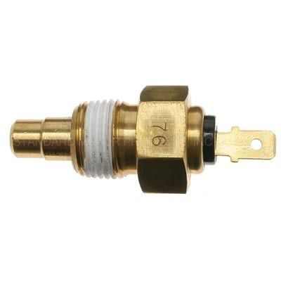

The stock connector was a sort of "mushroom" looking terminal, that the connector slid onto from the side. AFAIK that style is not available in the aftermarket. Doesn't matter; the stock connector goes right onto the currently available replacement ones, which are yerbasic ¼" slide-on terminal.
They didn't have ECMs in 1955. The temp gauge didn't need that then and doesn't in 84. Dk grn wire, runs from the sending unit to the gauge; has another wire that runs to the ignition switch, such that the gauge will peg when you turn the key to start. Been that way since 1955.

Thank you for all the info. Unfortunately it looks like that connector was cut off at some point, so I'll have to look for a replacement. The sender looks like the attached photo. I made sure the connector that was there was fully attached, but it's a no go. I'll try to get the factory parts and see how it goes. I'm assuming the next step would be to find and follow the wire that goes to the ignition.
