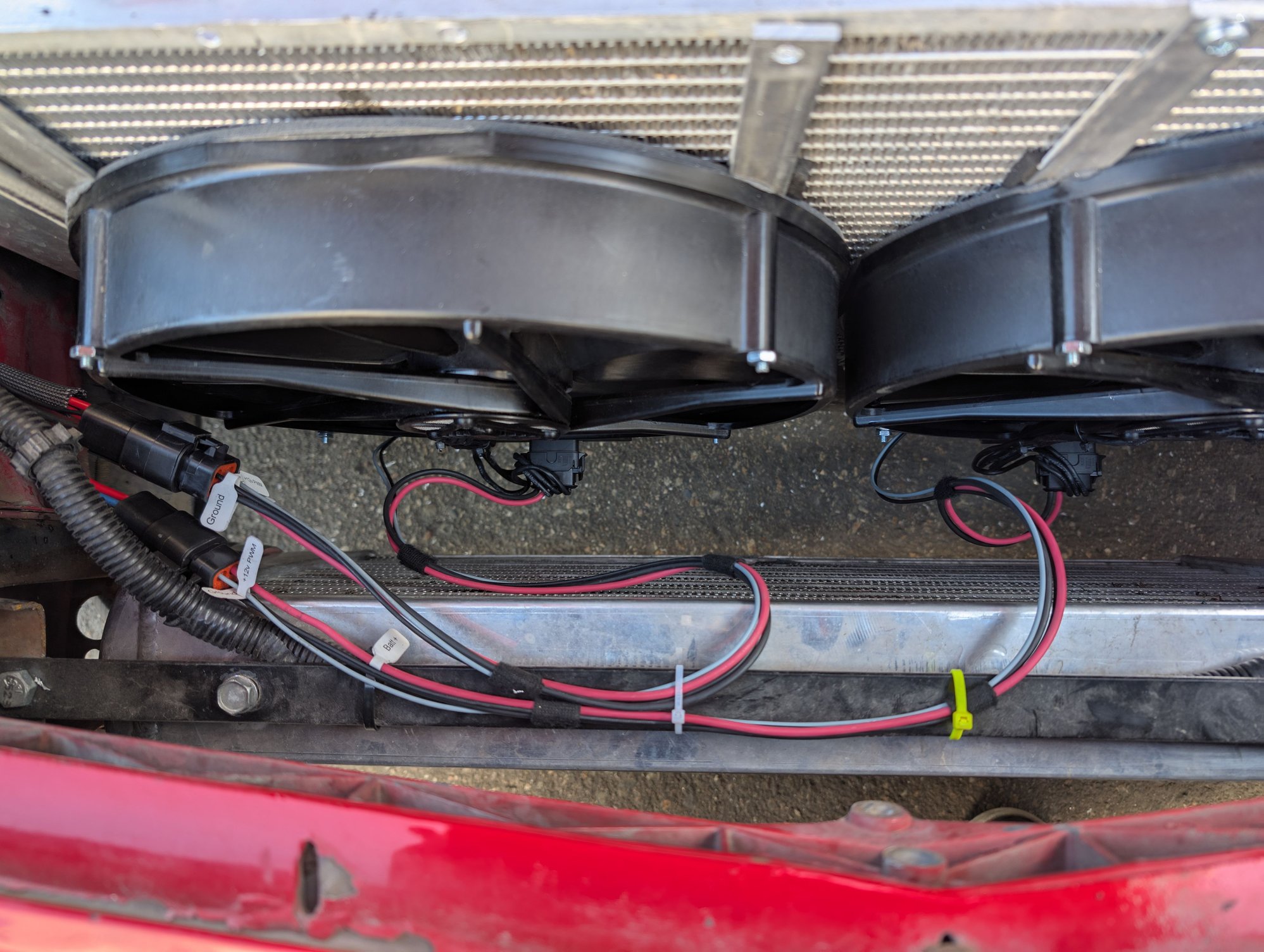

Got my Delta PAG fans mounted and wired up yesterday. Very high quality stuff and do they ever move a ton of air even for pushers! The fans come pre-wired out of the box with Deutsch connectors all I needed to do was wire up the power and grounds and put it into the female Deutsch connectors. I also got their dual fan relay block which made the wiring look much cleaner than two separate relays. For now I'm just turning the fans on/off with the Dominator, I'm still working on the variable speed table. I really like the soft start of this setup, no nig hit to the electrical system and it slowly ramps up.
Mounted using aluminum flat bar and bolted to the radiator. The fan ECM is at the bottom where it's not as hot
