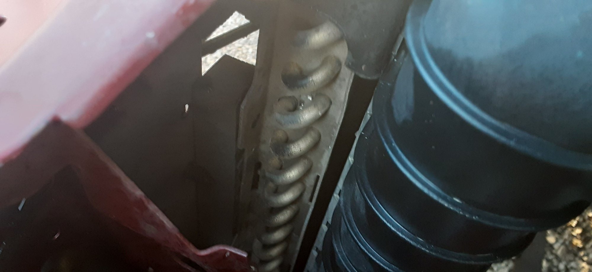

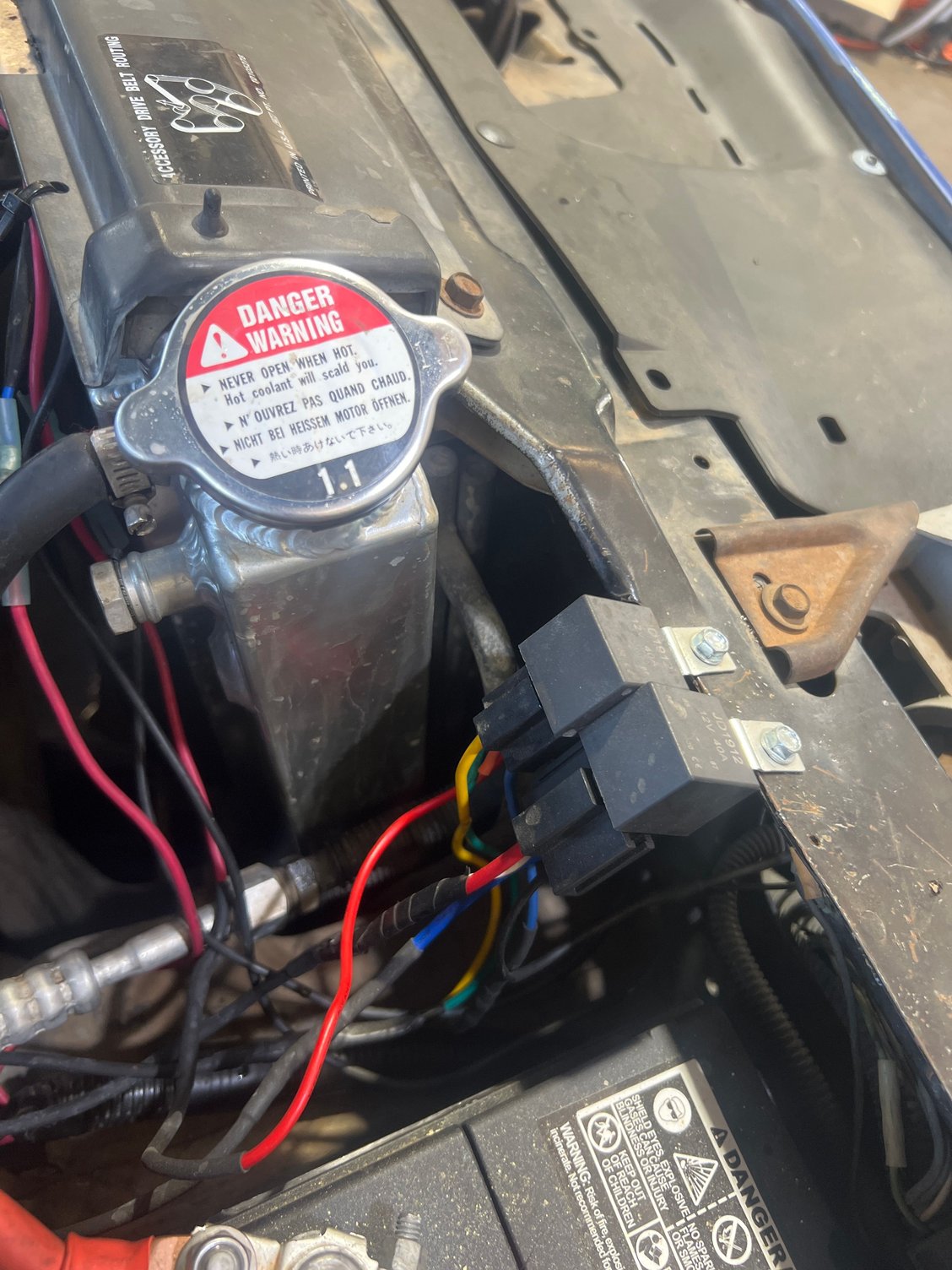

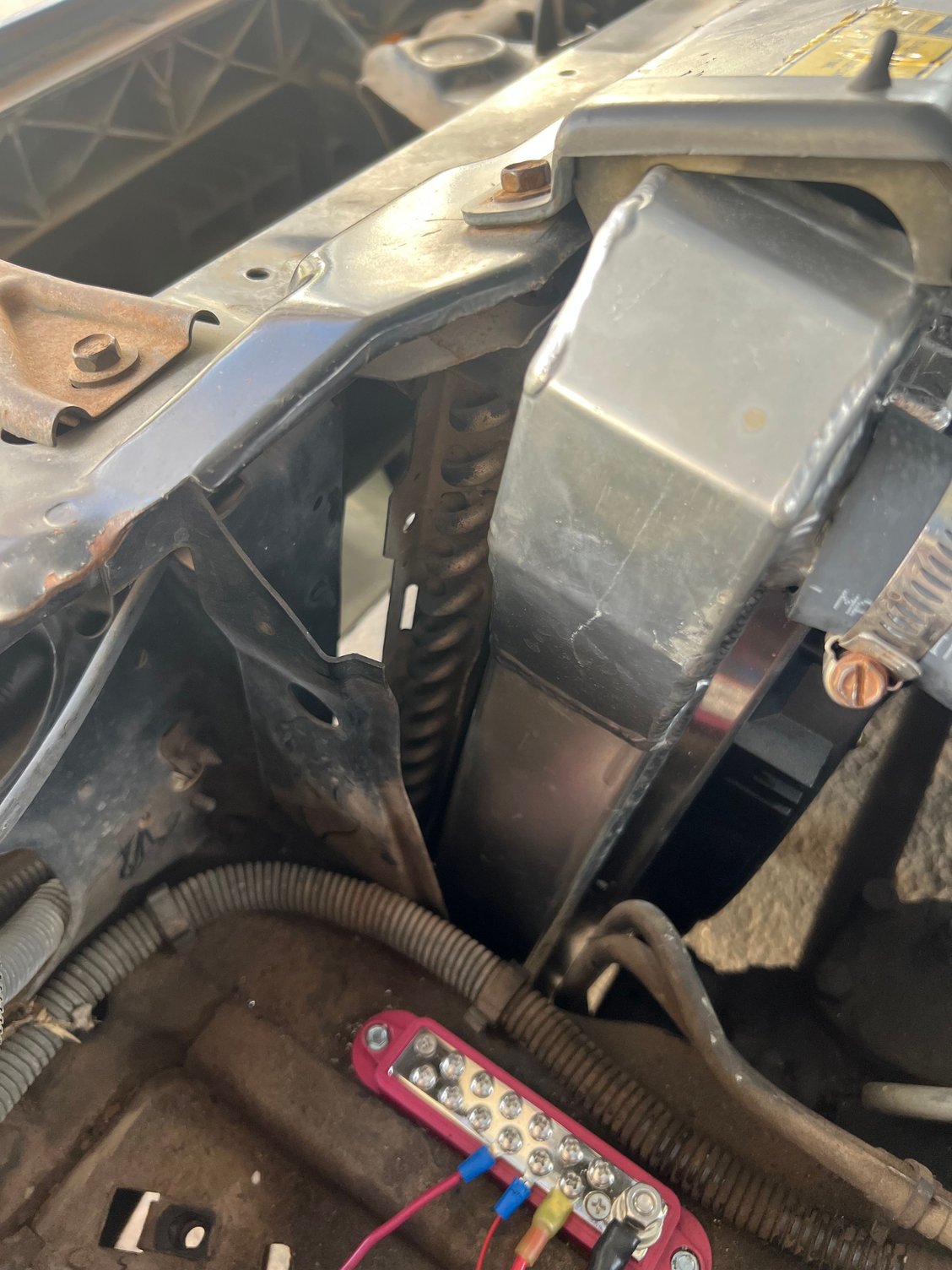

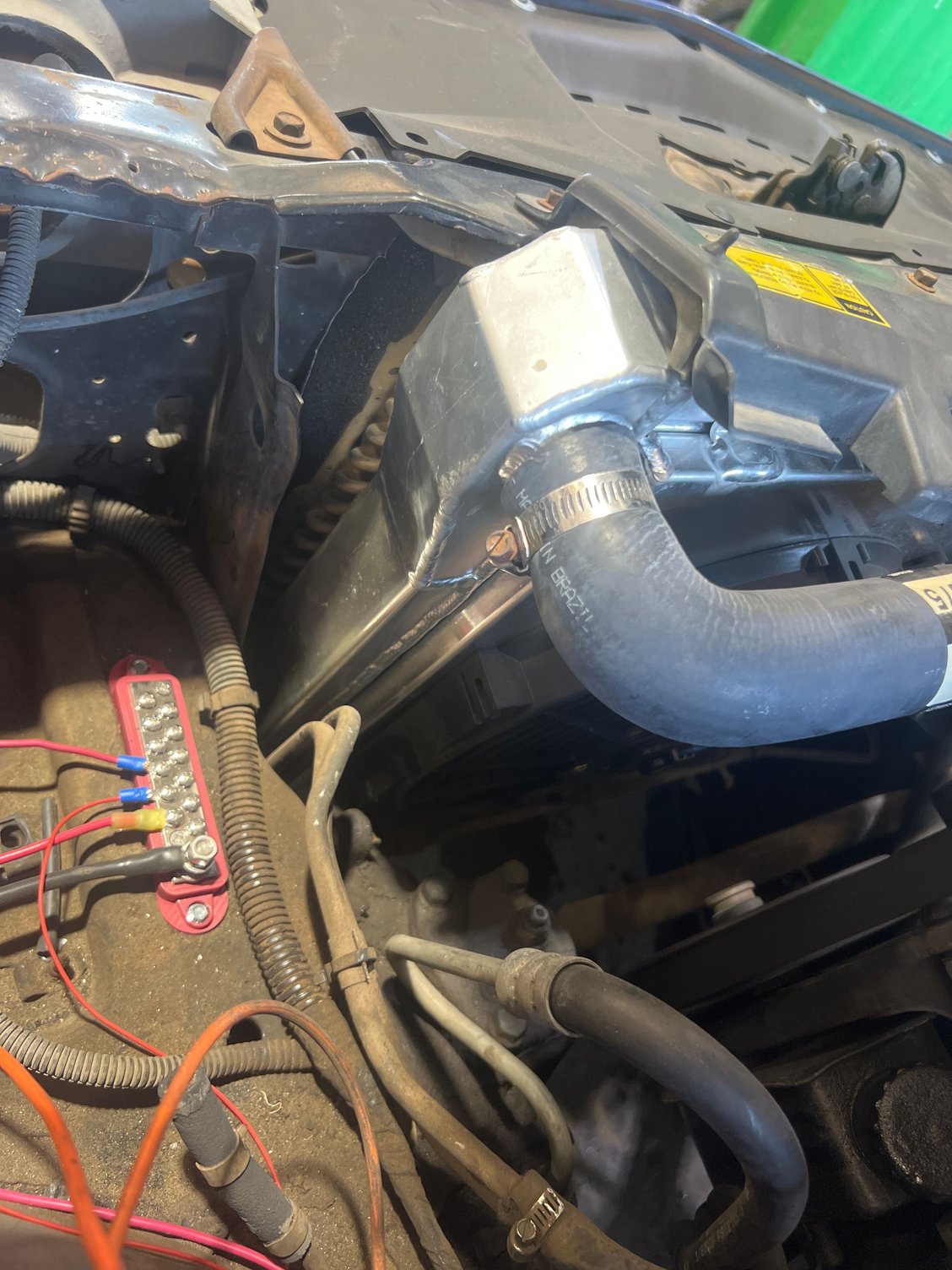

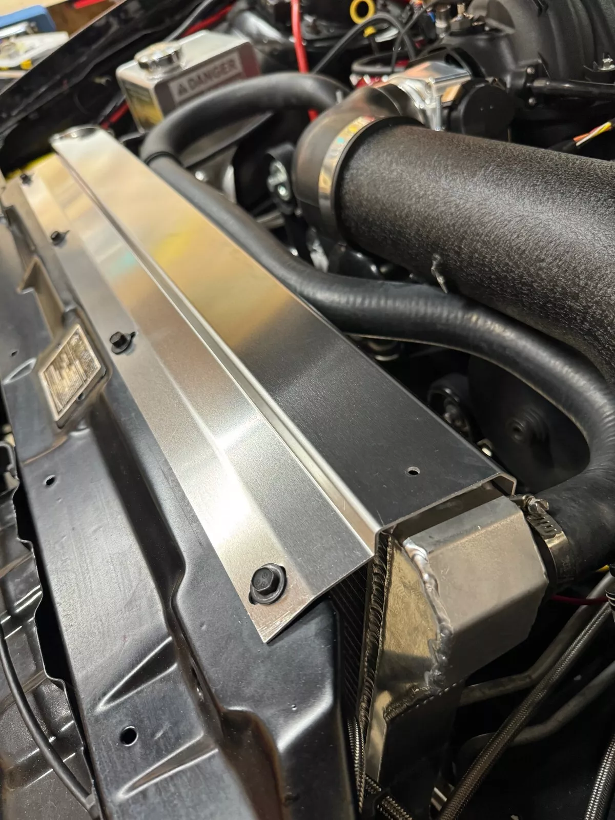

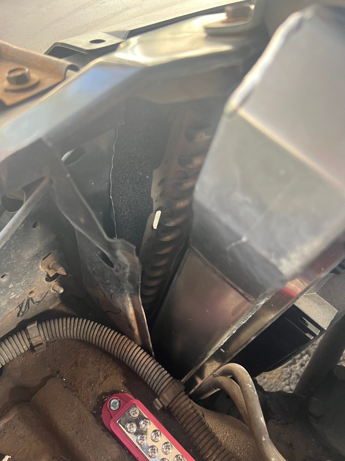

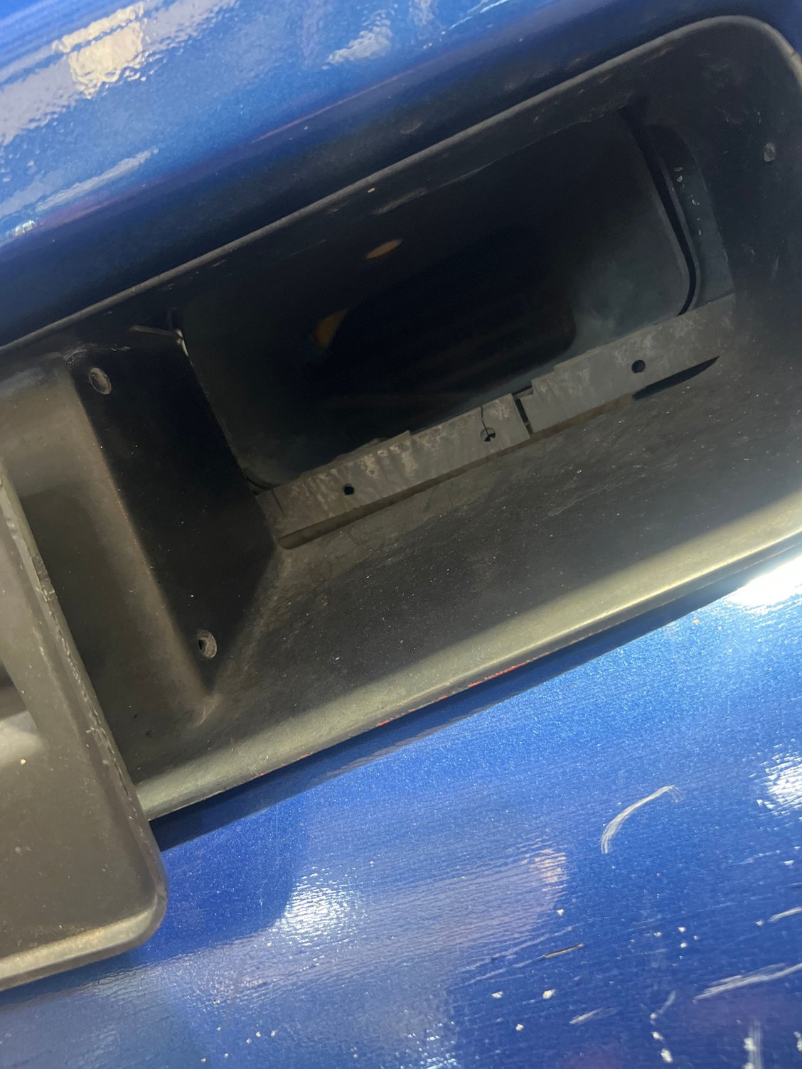

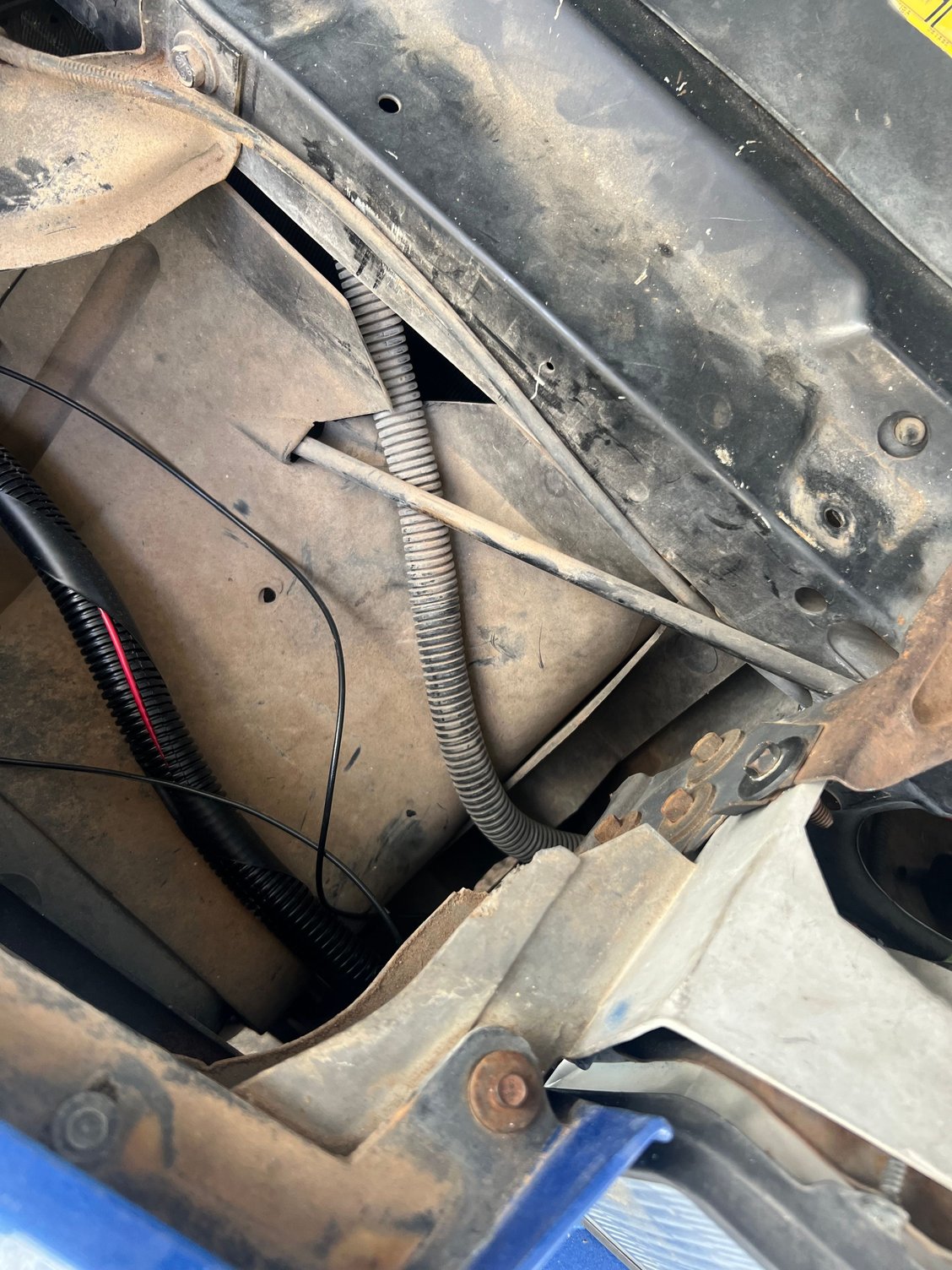

This is from inside the engine bay on the drivers side. Is there supposed to be attentional ducting here?

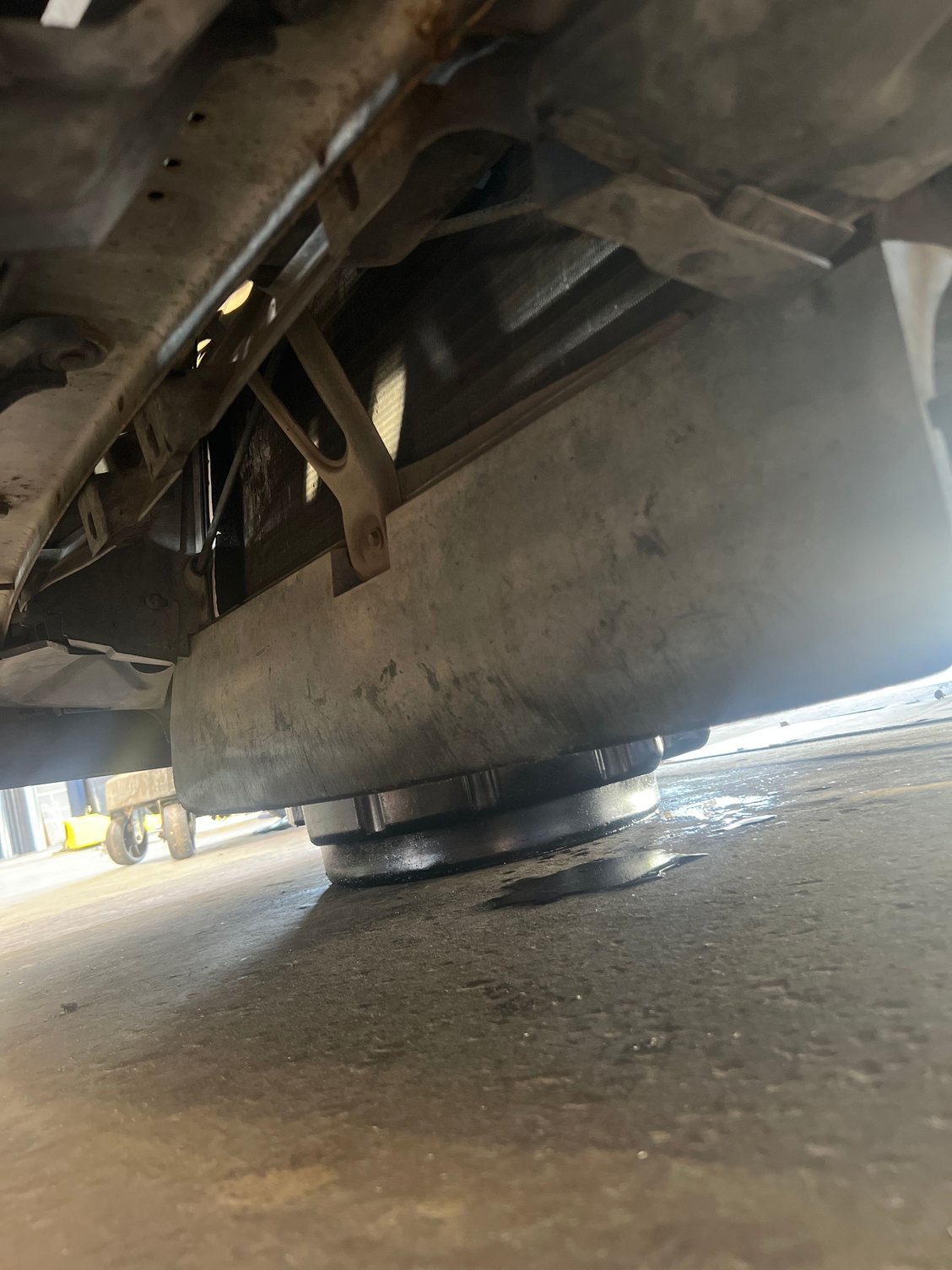

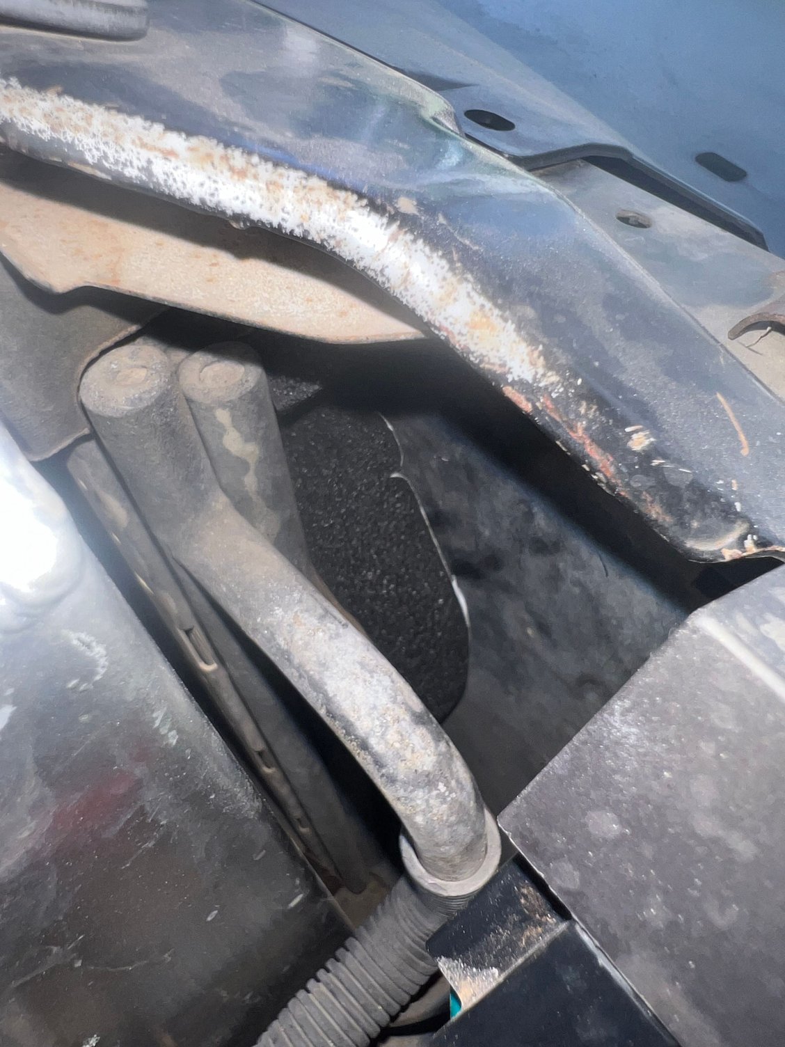

And this is the ducting from in front of the radiator, it does have its side ducting here.
is there meant to be additional ducting on the sides of the radiator to seal it to the front/side ducts?

You have enough radiator there to cool a 12 cylinder tank engine when a stock style radiator that would have fit and bolted right in would have done the job.
The answer to your problem was given to you in your other thread when @ULTM8Z linked you to another guy having the same problem. I gave the solution to his problem in it.
I have done everything and it still overheats in traffic.
Everything takes the path of least resistance. Your car is also missing the sheet metal piece that goes from the front of your car to the core support. The way your car is setup now air is going to go everywhere but through the radiator.

I have a reproduction panel from hawks on order already for the front. I’ll make some block of plates for sides of the radiator and take the car for a drive to hopefully see a difference.

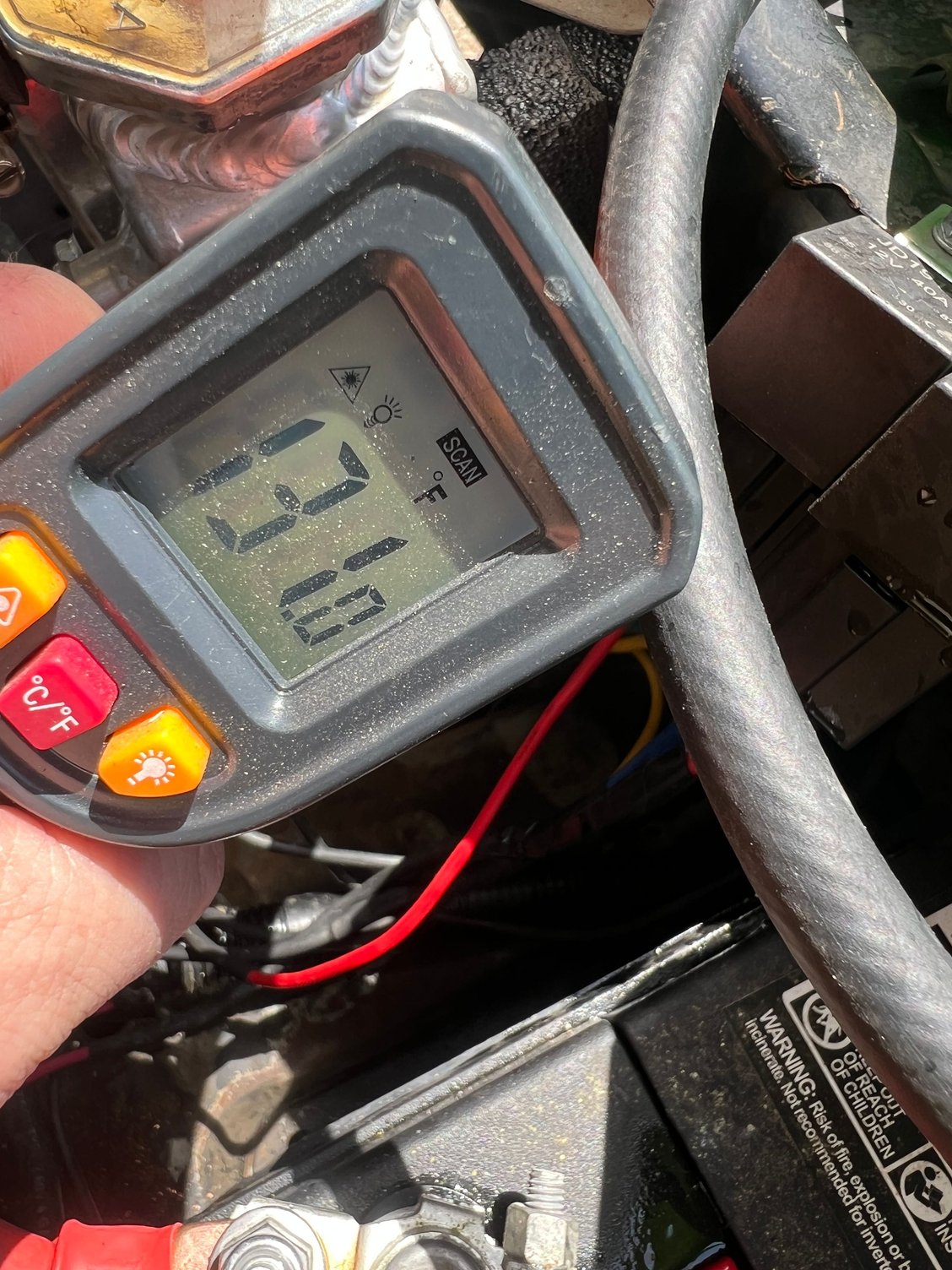

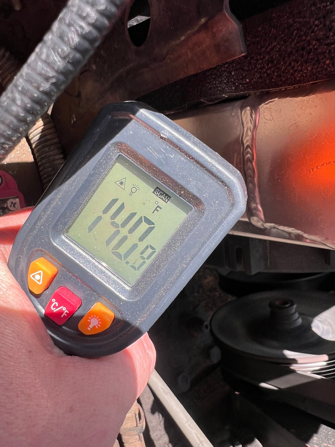

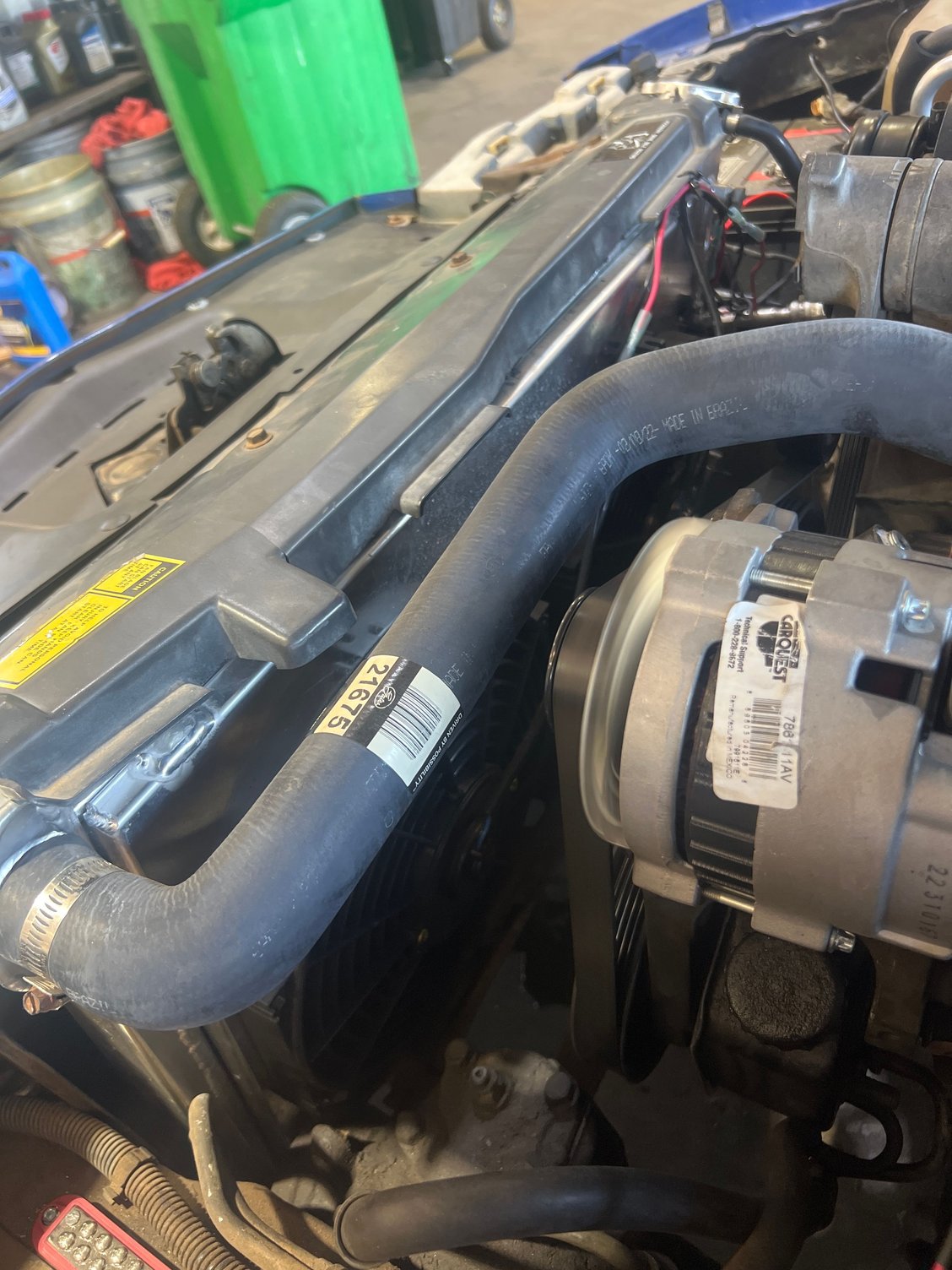

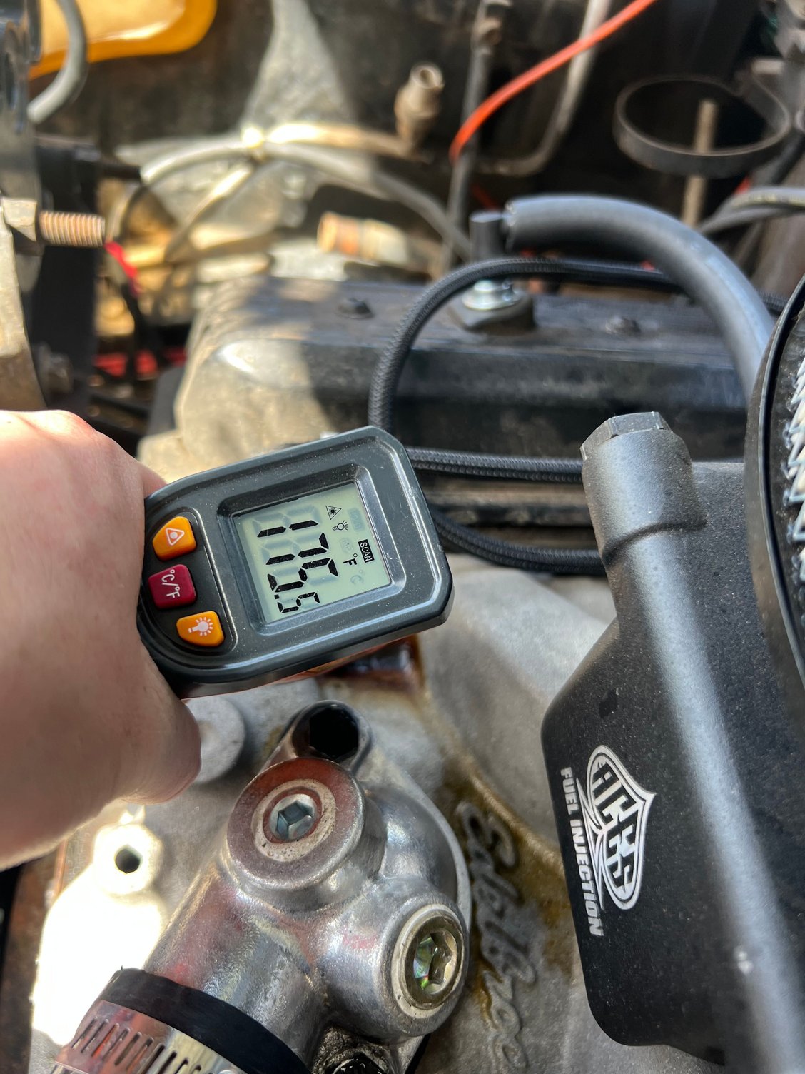

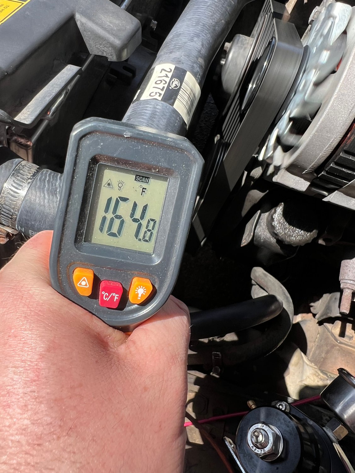

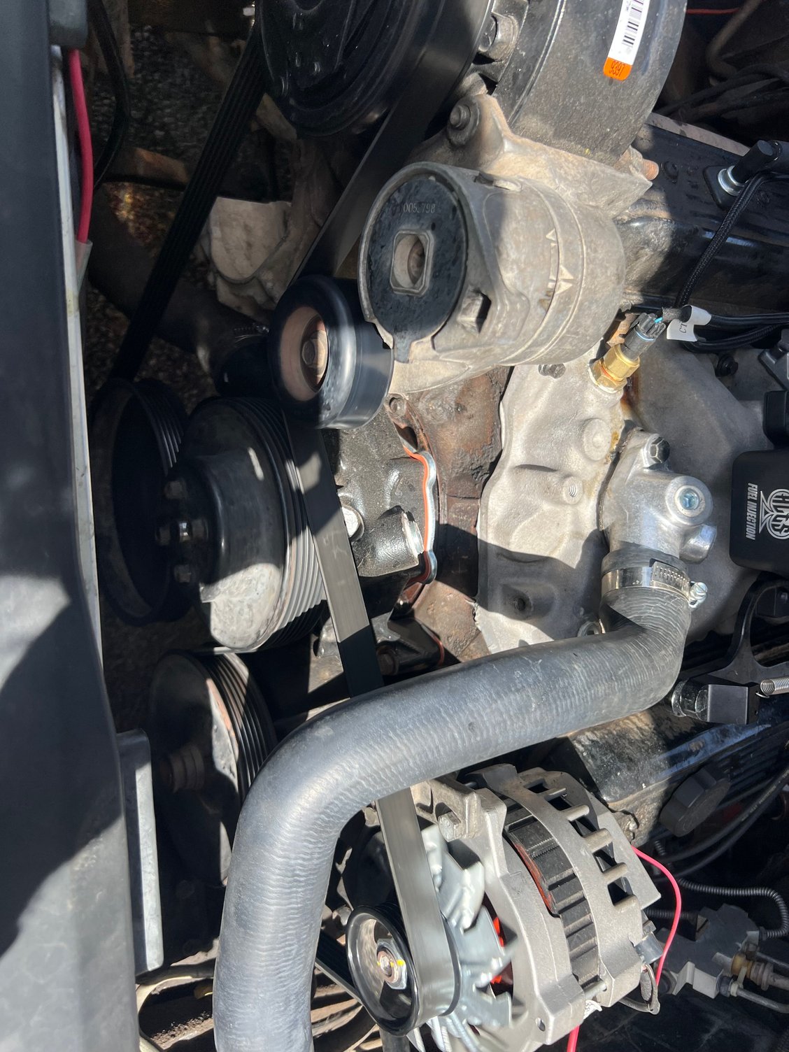

The serpentine drive system is all stock except for an air pump delete, this is the correct belt routing yes?

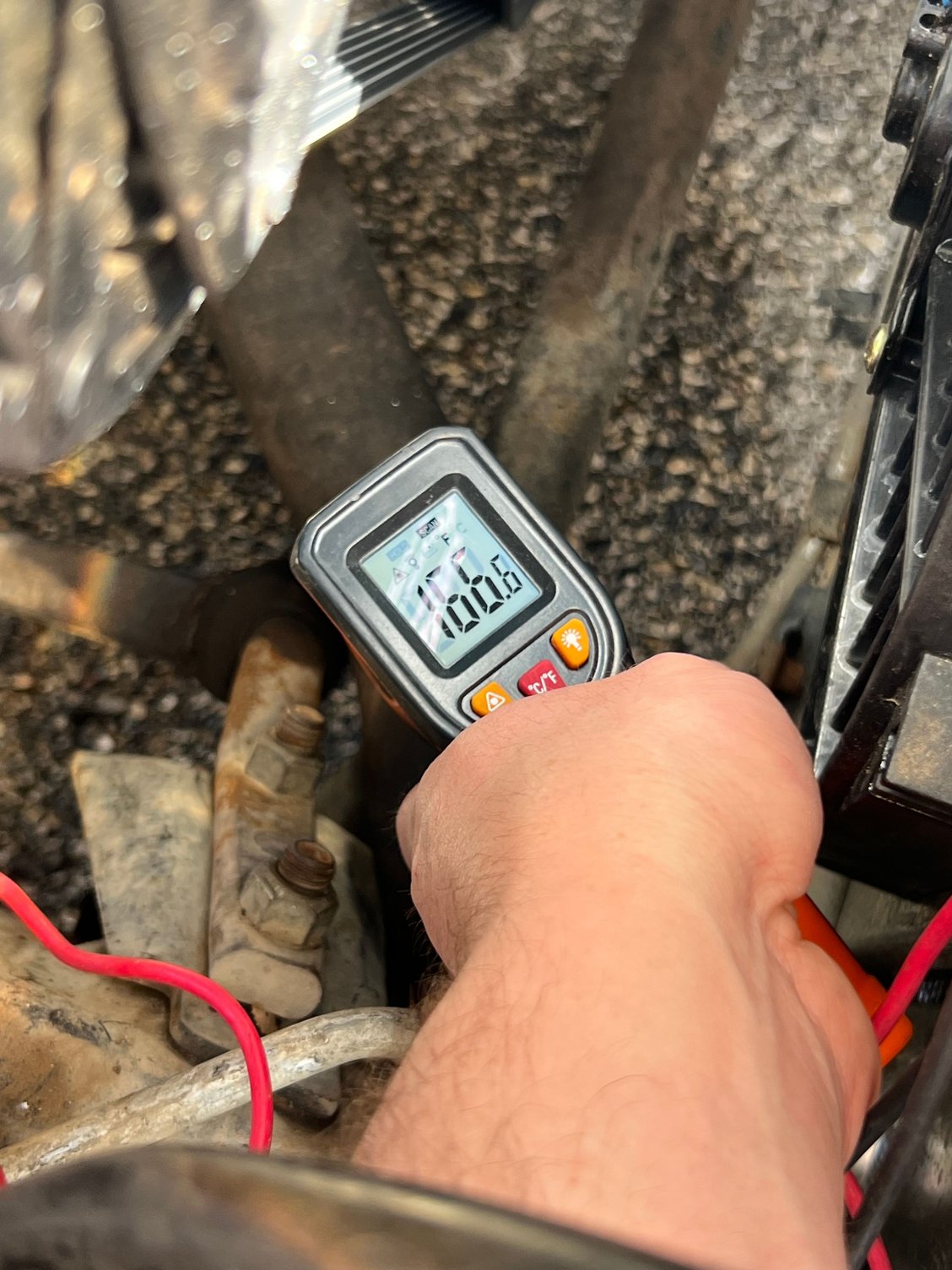

175~ read at the temp sensor. 185 in the digital gauge
Upper hose temp
Upper hose temp
140 about 3 inches below hose inlet on drivers side
131 about 2 inches below cap
166 at lower radiator hose about half way between radiator and water pump.
Pressure tested system again. Found no leaks. Held pressure at 18psi. Block tested again and passed again. Verified no air in the system. Does not seem to be an airflow problem considering highway driving doesn’t help at all. But also can’t find any signs of failed head gasket or cracked head. At a complete loss. I had an overheating problem when I first bought it, since then I’ve changed the entire cooling system and still have an overheat concern. I feel like I have nothing left to suspect other than the engine internally.

Sure looks like a v-belt,CW rotation WP in the pics with the capped off heater return port on top-do not recall seeing that on '88 up CCW water pumps.Also pulley bolt circle is smaller on the CCW pumps,so if pulley bolt holes have been modified that is the reason. Weak circulation from wrong pump should have same effect hood up or down ...

I checked the part number for the water pump he bought and it is a reverse rotation water pump.

How about the right part number on the box but the wrong rotation pump inside?

I looked at all my '88 up SBCs and found my '91 G30 van has a pump that looks like the subject one - Has the top fitting,but no alty bracket lug. Correct for CCW rotation....
Upper hose temp
Upper hose temp
IDK.....that REALLY looks like a lack of coolant flow to me. Sounds like you've confirmed that it's not the wrong pump. I guess at this point, I'd pull the stat out and try it....or pull the pump and look at the impeller and/or see if it pumps water. You're showing 175 at the neck, and a drop to 160 at the upper hose nipple?? What cooled the water 15* in the 2' rubber, upper hose? Hmmm....
Then your 130* on the cold side tank, but 166 on the cold side/return hose? Hmmmmmmm.....That lower hose water his being heated by heat transfer from the engine, IMO. Should be the same temp as the cold side tank.

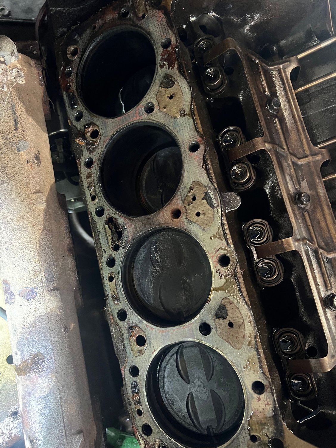

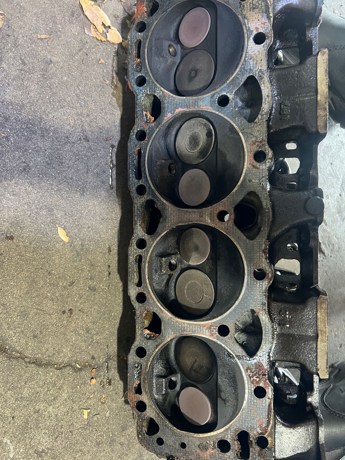

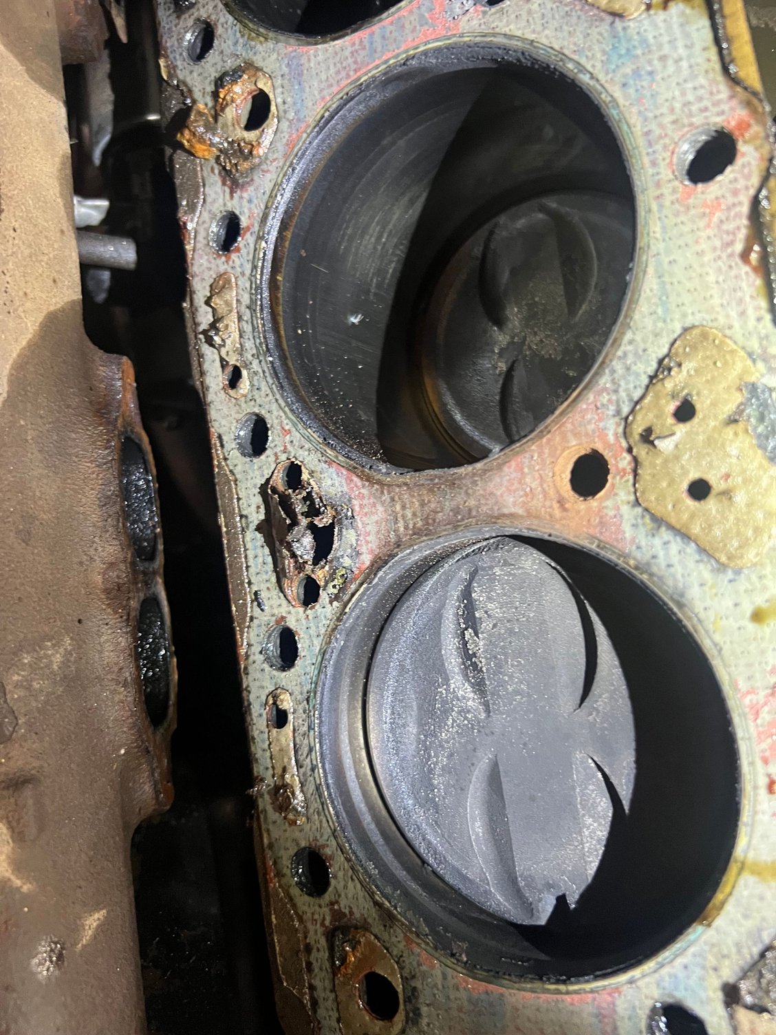

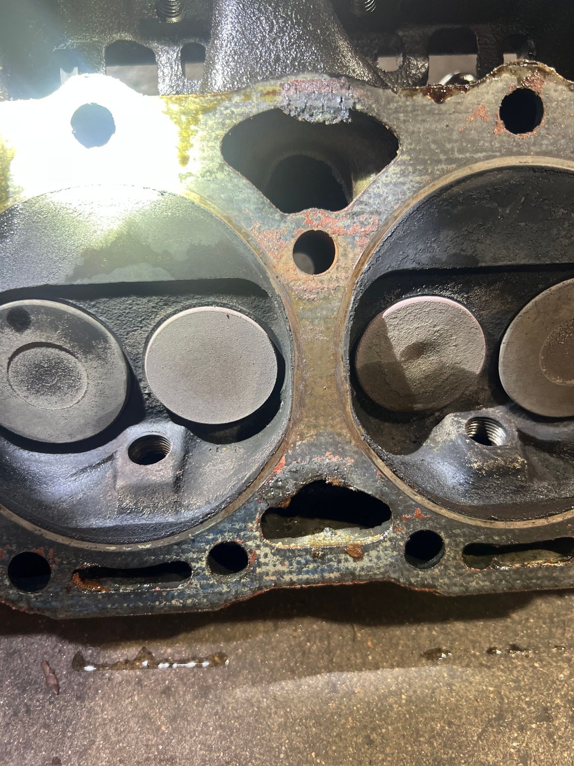

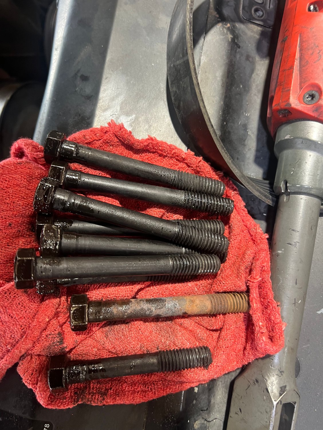

Well. I loaded a pretty expensive parts cannon and yanked the heads. Between both side of 17 head bolts, 1 bolt had water intrusion. The side with water intrusion through a head bolt hole also has 2 valves that have been replaced previously. Putting on another set of 081 casting that have been gone through at the machine shop with felpro 1094 gaskets. Found a lot of loose/incorrect bolts a previous owner as well. Should know soon.
Old Mar 29, 2025 | 12:13 PM
8t2 z-chev's Avatar
Joined: Jan 2009
Posts: 2,317
Likes: 116
From: belle fourche,s.d.
Car: '82 z28
Engine: L83 5.7
Transmission: 700r4-1985
Axle/Gears: 3.42 posi
Re: Overheat only with the hood closed.
Pics 2 and 3 sure look like head gasket seeping compresson between those two middle cylinders-head likely warped pretty bad to do that on a 305.Should run nicer when back together
