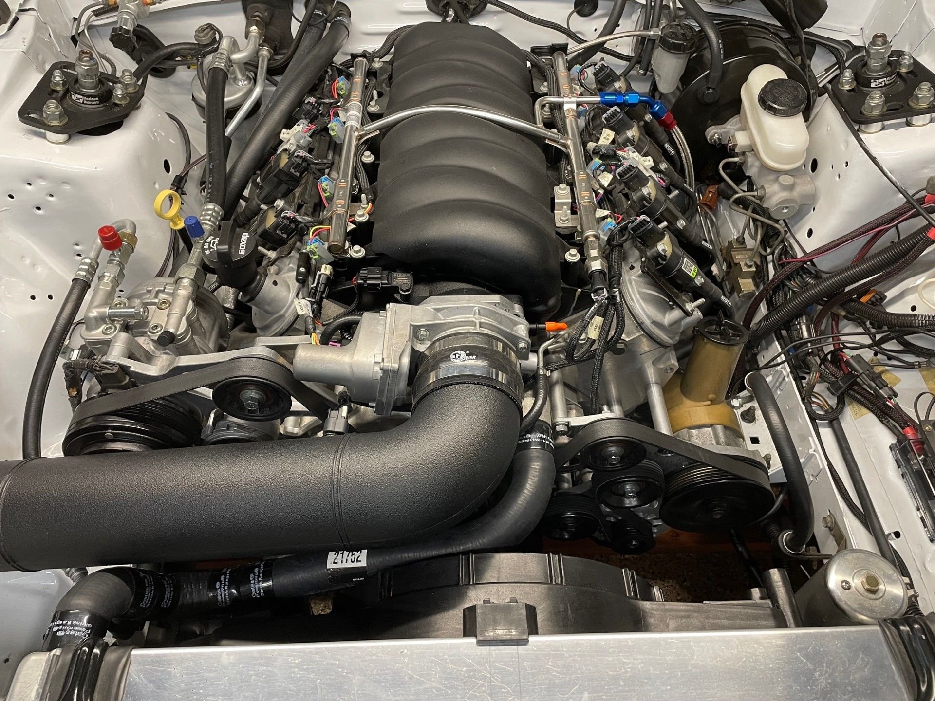

I really wanted to low mount my AC compressor on my LS7 swapped IROC project. I've got a high mount compressor on my LS3 swapped Foxbody coupe. It was easier to mount, has a lot of room, easier to work with AC hoses, etc. However, all of that is in the way when I need to deal with plug wires, plugs and so on. In addition, to me, its a cleaner look when everything is down low. However, I think that I'd rather suffer through all of that instead of suffering through Houston summer heat and 60F vent temperatures at idle speed!

Originally Posted by dannyual320
Sounds like you had good condenser/radiator air flow. 20F colder at idle through the center vent is significant. 20 degrees colder at idle is what I experienced going from my Mustang's inadequate, OEM mechanical fan to the high powered, Lincoln MKVIII electric fan.
This was with the bigger SD7H15 after I put it on the L31 350 swapped into my 87 G20. Totally inadequate on my 97 Express and borderline functional on the 87 G20. I still find it lacking in stop and go or slow moving traffic. Luckily it spends most of its time on the open road, not in town.
