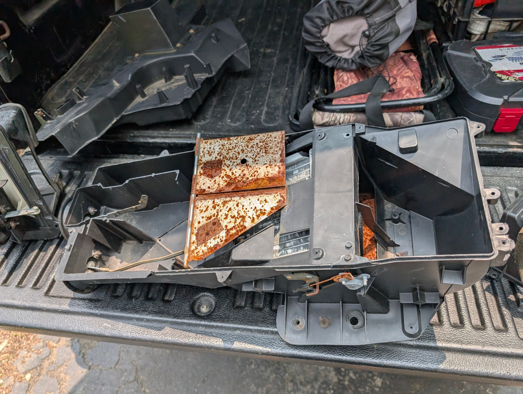

I recently picked up a 87 GTA project. The previous owner removed the AC/heat and all interior duct work. He gave me the engine side box. Looked in ok shape, some cracks at the bottom. All interior parts are MIA.
I'm trying to determine what parts I need to track down to get the interior stuff back together and what year cars are compatible.
Does anyone have a resources I could reference? I've been searching but coming up empty? I'd image I'm limited to 3rd gen cars for parts.

I think pics would help. it's rather unusual that someone would actually remove all the interior parts. they actually removed the dash and removed the ducts etc? it is a PAIN.....
Normally they just remove the compressor, evap core and the out side box and install a non ac box.
Purchasing and installing the individual missing parts may be a pain honestly without a donor vehicle / dash assembly.
Here's the car right now. I pulled the dash because the wiring was all unplugged and the dash was only partially installed.
I also met up with the P/O who managed to track down some of the removed AC components but I am definitely still missing a bunch of it
