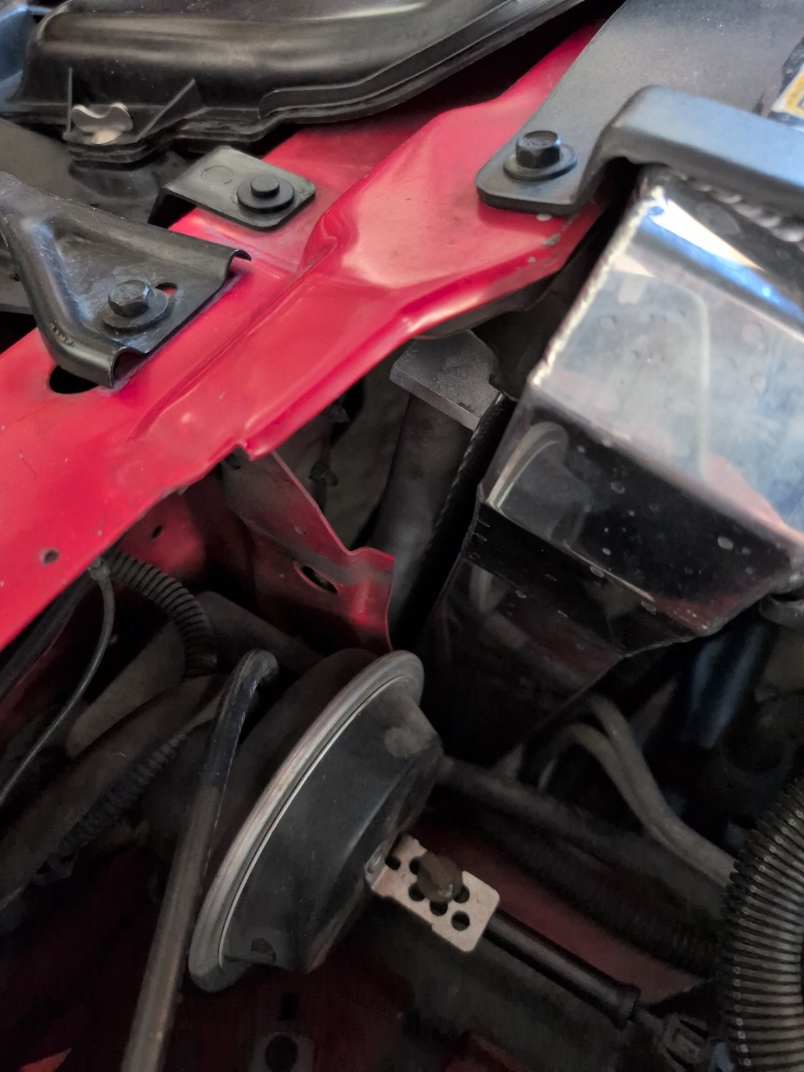

'Only reason I'm asking is because I sometimes see posts here saying that if there isn't a seal between the fan and radiator, that the air might be pulled around it rather than through it...

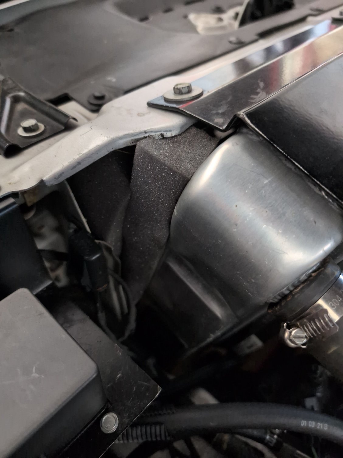

Could be referring to the radiator to body, not so much radiator to fan.
Foamage...
No foamage, yet...
