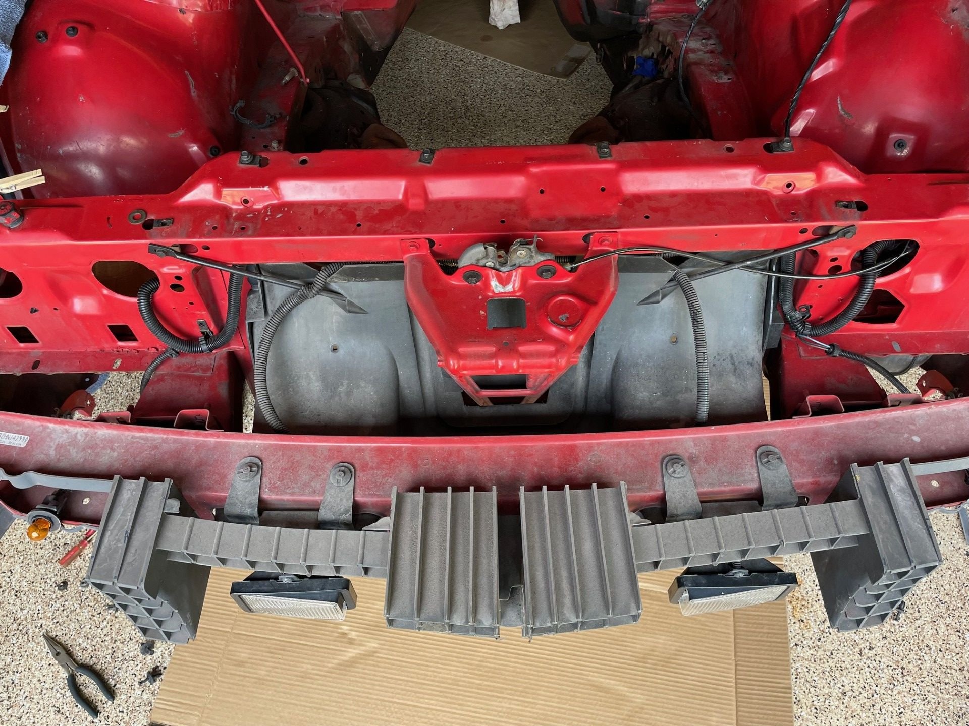

Awesome pics man! I also see the airdam, that was my first train of thought, so I can discount that. The fans were fine from the factory as was the cooling system. The symptoms confirm it is an airflow thing, as it happens only on the move- from the factory, the fans stop running at over a certain speed, I wonder if you having them on all the time is helpful or not. It kind of rules out the rad and fans if it is working in traffic/ stationary. Could be a few things, some suggestions in order of what I think-
Airflow is key for these cars- trans cooler will not help, you need as much circ as possible

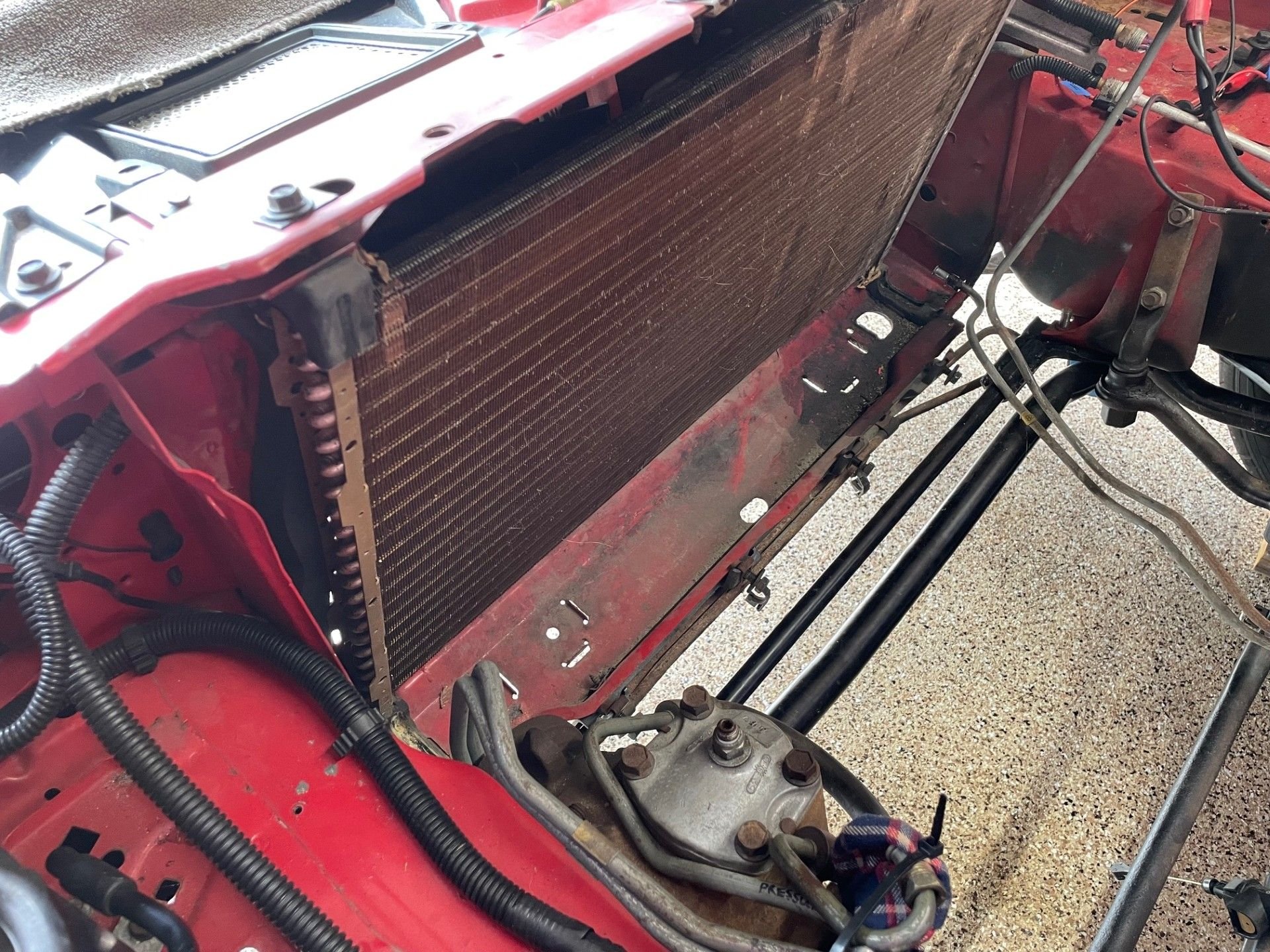

Last summer, my LS376/480, Tremec T56 Magnum swapped 1991 Foxbody Mustang coupe was tending to run a little warm on the highway (210-220F) but at slow speed below 40 mph, the engine temps would cool down to about 200-205F. Why? Because the PWM, brushless, C7 Corvette fan was pulling a huge amount of air through the radiator when it was commanded on at speeds less than 40mph. I posted this info online and someone asked me if I had my car's plastic airdam in place. I told them that I had it in the garage but not on the car. I installed it and what do you know? Now it cools better at highway speed (less than 200F) than it does with the fan running at slow, less than 40mph, vehicle speed.
People have already asked it your car has it's airdam in place. I can see the airdam in one of you pictures that you posted so I'm going to assume it's in place. However, there is more than just the airdam for routing air properly in a 3rd gen Camaro. Here is a picture of my 1987 IROC with the front cap removed:
Does your car have that black plastic piece that is right in front of the radiator in this picture?  That plastic piece is routing the air where it needs to go for proper cooling.  You gotta have it in place.

No, you absolutely don't have to have that black piece, only the lower airdam under the car.
The first thing I'd do is put in a stock radiator and see what changes. The 4 core is an answer looking for a problem IMO.

Mine was missing, I still don't have it, my car will not overheat in any condition especially with airspeed so it's not diagnostically relevant to this scenario.
My guess is poor / no sealing around the radiator combined with it being too thick acts like a wall and the air would rather go around it.

That's definitely plausible.
I fully agree with the rest of your statements except I'm not sold on 4 core radiators being too thick to allow sufficient airflow through them. My car is undergoing an engine bay repaint and then a complete LS7/Tremec T56 Magnum F swap. I know that there was sealing foam between the radiator support and the radiator. It had two sided tape and when I removed the foam, all the tape stayed on the radiator support. I kept the OEM foam but I'll probably just buy new foam. It will get sealed!
I don't own a 4 core radiator but I do have a twin, 1.25" core aluminum, Cold Case radiator in my 1991 LS376/480, Tremec T56 Magnum swapped, 1991 Foxbody Mustang coupe. I installed this radiator about 6 weeks ago this radiator is the bomb! I can't believe how muchl this radiator cools my engine at highways speeds. I've got a 187F thermostat and at highway speeds with the AC on, 90F ambient temperature, the engine runs at 188-190F. The Cold Case radiator is chinesium for sure, but I'm really impressed. So much so that I've already purchased one for my IROC.
No reason to have an electric fan running at vehicle speeds above about 35-40 mph. My Dominator turns off my Mustan'g C7 Corvette PWM fan at speeds above 39mph.
Looking at this picture, it actually looks like the OEM foam seals the AC condenser to the radiator support.  In any case, it helps funnel the air through the condenser/radiator.
Looking at this picture, it actually looks like the OEM foam seals the AC condenser to the radiator support. In any case, it helps funnel the air through the condenser/radiator vs around it.

Originally Posted by TheMagikMan
Originally Posted by Airwolfe
Well I been thinking about asking you this question for a few days now. But sometimes I don't like to ask a bunch of questions because I feel like people might take it the wrong way and think I'm personally questioning them and get insulted by it. Kind of like "How dare you ask me such a simple thing, Do you take me for an idiot?"
This picture is worth a thousand words. It tells me everything I need to know.
As Eric O of South Main Auto would say... "There's you're problem lady!"
I'm sure you have been trying to figure this out for a while now. So waiting another hour ain't going to hurt anything. I'll give my theory as to your cooling problem an hour from now. Give some time for the viewers at home to play along and comment as to what they think the problem is. The answer is in the picture.
I have a feeling if the OP replies back with pictures we might see something like this as in the thread below.
I have done everything and it still overheats in traffic - Third Generation F-Body Message Boards

i watched a video on youtube, guy having same issue, and fans are only 800cfm, and 3000 required for a v8, so i ordered bigger fan motors, and also realize from the pics, i need to seal around the radiator, theres prob a half inch gap around the top and both sides, so after the fan motor swap, ill get it sealed with some foam tape, but i dont have the hood weatherstrip seal, seeing as how i have a tracspec louvers in my hood, dont see how it would help any, but i could be wrong
heres a few pics

Thank you, #dirtyeyez for posting the pictures of your car's cooling system. I noticed that you don't have the black plastic piece that I pictured in post #6. Komet did say that it's only there to prevent rocks and such from hitting the condenser so maybe it isn't needed.
Seal up your condenser/radiator and let us know the result. Hopefully, you get better cooling and you'll be done. If not, you might have to try to find one of those black plastic pieces.
I'm also interested in whether or not the functional hood louvers negatively affects engine cooling. I was planning on cutting my hood and installing the functional louvers.
heres a few pics
The black swoopy plastic I believe is to prevent nasty road crap from being sucked up into the TPI airbox and separate radiator air from engine air. The carb and TBI cars didn't have from what i've seen. But they did have a closeout between the fascia and core support to keep air moving through the rad, rather than over it, and it appears you are missing it. As to the fan CFM, I moved from a pair of SPAL 800s to 1470s and, well, the big boys certainly needed to have their on/off setpoint adjusted. They're also so loud that I was rolling through the costco parking lot and I wasn't sure if people were looking at me because of how the car looks, how loud the exhaust is, or how it sounded like a DC-8 taxing to the runway as i was approaching them.
*edit* it looks like you have the closeout in one of the pictures, so nvm that, but 19psi on the rad cap seems way high. I think these motors were designed for 15psi.

Oh, they absolutely can. Cap pressure regulates the boiling point of the coolant. If they're too low pressure or don't seal right, it'll boil rather than circulate. Too high pressure, well, hopefully you'll blow your hoses before your head gasket.

Fans do not cool your car at speeds of above approximately 35+ MPH.
You can literally, and I mean the word actually how it is meant to be used, take the fan shroud and cooling fans off the car and pitch them in the trash. Your car, if everything else is right, will never even know they were gone. It would actually even be better with them out of the way.
Back when I was young & dumb and broke too I had a 1979 Dodge D150 truck that had a 318 V8 automatic no AC and I had access to a rusted out 1978 Dodge Aspen 318 with AC and tailor towing package. The truck only had a fixed 4 blade fan, no shroud, no overflow bottle, and a 22" single core radiator. The car had a 28" 2 or 3 core radiator, 7 blade asymmetrical HD fan, a HD thermal fan clutch, and a HD water pump, a fan shroud, and an overflow bottle.
By eyeball it looked like it would all swap. It did like the factory put it all there except for me having to cut open the core support on my truck for the larger area radiator. Worked amazing.
Then the thermal fan clutch locked up tight as a drum and my truck sound like a jet about to take off. I removed the fan shroud, clutch and fan assembly and drove it that way for like 2.5 years until one day I replaced the defective fan clutch with a new one.
That truck never overheated. Not even in boiling hot summer with No Fan at all.

Put the cowl to hood rubber weather stripping back on the car, make some temporary cardboard seals for the top and sides from the core support to the radiator and tape them on. Box in the opening around the core support to the radiator so no air can leak around the radiator.
Take the car for a drive.

Your radiator install actually isn't all that bad looking. Fits better than the other guys radiator did.
I'm going to send you a link when I find it again of a fellow third gen member on the site here that makes a nice upper radiator cover that will work with your radiator.
Your transmission cooler needs to be remounted or sooner or later your are going to get a leak in your AC system and you and the car will be hot.
You and your Dad need to make a mount for it that gets it off the AC condenser and gets rid of those through the core zip mounts.

You can seal off the radiator to the core support with expanding garage door weather seal. I do this and some other things you may benefit from in my old trans cooler thread:
https://www.thirdgen.org/forums/cool...oler-redo.html
Note: I've bought this stuff more than once and the second time it wasn't as dense. Try to get the thickest, densest foam tape you can.
Double note if you do read that thread: I still think about how I need to evaluate my actual potential and how my car is headed to the crusher .

Yes, i meant to type, 4 core radiators are 1980s technology.
I also stated the 66 biscane in the shop had the same issue, air going around the radiator and not through it.
I shoved in a bunch of cardboard to funnel air into the radiator and not go around it, and then reomved the 2 cooling fans and took the customer on a 15 mile test drive at 112 ambient to show him the outcome.
Now on the white camaro pictured, there is a huge opening between the bumper and core support at the bottom. fix some cardboard there to close the gap. I bet air is going down and under the car and not in through the radiator.
Heating issues suck, but you just got to use a bit of common sense. Air needs to go through the rad.
The factory seals and air dams need to be in place, and at one point the factory designed these cars to not over heat, got to get back to the simple basics and make it happen again.

ok, well the new fan motors arrived today, i got them in, and took her for a ride, give her hell for a little, and then a steady cruise, the whole time she stayed around 180, pic posted below, i installed the plastic nose piece and swapped the fan motors to the pics below,the ones that came with radiator was 80 watt, swapped to 180 watt, so in all, i have a whole new system, 4 core rad, hoses, thermostat, water pump, and the new fan motors kept her cool, who says you cant keep a 3rd gen around 180 on the temps, very happy now, pics of rad and fan motor upgrade
and temp while driving, never got any higher....
also, the trans cooler has about a 2 inch gap between the ac condenser , not directly on it... but yes, will be relocated

#dirtyeyez, awesome to hear that your car is staying cool while going down the highway now!
You posted, "i installed the plastic nose piece and swapped the fan motors.... What plastic nose piece did you install?

i stole this pic from another thread, its the piece with the red arrow, i took it out so i could take the chin spoiler off when we repainted her, and forgot to put it back on......but now its back on, and everything seems to be ok now, but the outside temps was not too high yesterday, so im waiting for a really hot day to take her back out and see if the heat makes a difference, but i feel like its a problem solved , but im still going to move the trans cooler, prob buy a new one with fan made to it, and try it out, and also get some foam seal, and seal around the radiator better, but fans made a huge airflow difference and are no louder than the old 80 watt ones, the fan motors are 4 bolt, old ones was 2 bolt, i had to make some spacers (1 1/4 inch, from old transmission cooler lines, and longer screws) so the fan blade location is in the same location in the shroud as it was with the old motors, very easy to do with a tubing cutter, and old trans hardlines, and i think thats about it, but if i missed or left anything out, please ask, and ill let you all know how i did everything
thanks for all the help and info you guys, i really appreciate it

Thank you for posting the picture to show what plastic piece you installed. The car in the picture that you stole looks like a Firebird. I don't remember that piece being on my IROC when I started taking things apart. Maybe I just forgot or maybe my IROC's previous owner removed it. I'll keep this in mind in the future for when my LS swap is done and if the car doesn't stay cool driving down the road at highway speeds.

yes, my 91 has it, kinda like a funnel, to channel the air towards the radiator ill get a better pic of mine tomorrow
