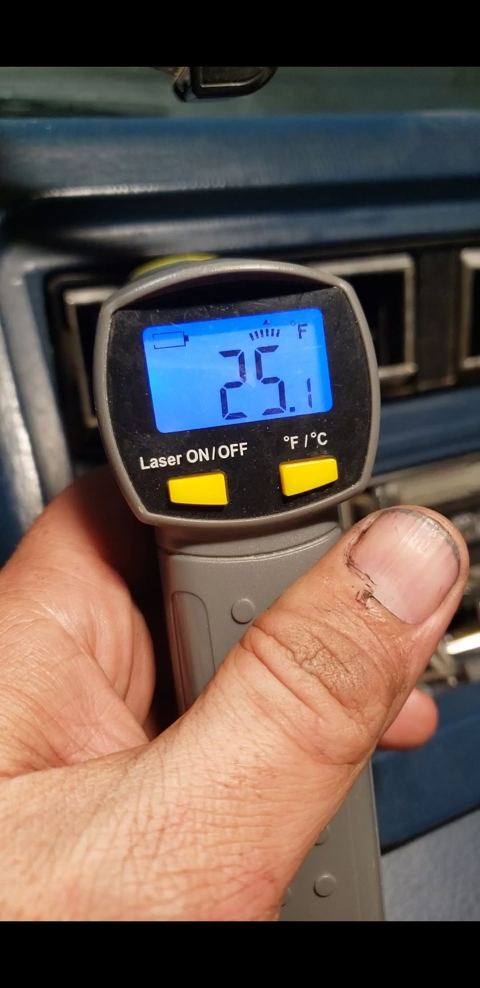

Works great but requires the same steps as a R134a retrofit. Needs new barrier hoses, system needs to be flushed, PAG 150 for a GM compressor, install the biggest parallel flow condenser that will fit, use a Ford Red 0.062" orifice tube. My last system rebuild/conversion from R12 cools like this in near 100F ambients with the engine at 2,000 rpm. Idle is in the mid-upper 30s but still plenty cool. This was right before the cycling switch cut off the compressor to prevent freezing the evaporator core into a solid chunk of ice. Freezing the evaporator core is the limitation to any properly working AC system regardless of the refrigerant in use. R134a was used in -10F deep freezers for years.
Just to give you an idea this is applicable to any R12 era system. The specific components will change depending on what vehicle you are working on but the steps remain the same.
https://www.thirdgen.org/forums/cooling/787755-gm-r12-ac-system.html

R1234YF is flammable but so is atomized refrigerant oil in any AC system. When the oil is atomized at high pressure during a refrigerant release it can readily burn.
The embitterant does not hurt the system at all. If it did I would have seen the effects a decade ago.
