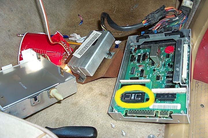

I got a couple of questions about installing a new chip. First, is the chip circled in the picture the chip that needs to be replaced?
Second, I am trying to find a chip for an 85 IROC 5.0L TPI. The problem is, the motor was replaced with a 350 w/ al heads from a 86 corvette. Since a 350 was not available for the camaro and I need a chip for a 350, what do I do? Do I try to get a new computer from a car that came with a 350 or find a chip that fits this computer that is for a 350?

I think that is the right one. But to be sure put the cover back on and open the little cover that has 2 screws securing it. The PROM will be the larger of the 2 under that little panel.
