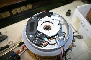

I will try to upload some photos,
This is the conversion of the HEI distributor to a 7 pin module for computor control of the timing.

This photo shows the lock out of the mechanical advance

Old Aug 27, 2005 | 06:52 PM
Z69's Avatar
Z69
Posts: 1,409
From: Texas
With a Pontiac 455?
They stopped making those a long time ago.
He was lucky Edelb makes an intake for it.
Thanks for the pic.
Any more info on the dist?
I know someone wanting to convert an Olds.
I always figured you could stick a 7 pin into an older 4 pin large cap.

So you are not just starting out with a small cap distributor from like newer computer controlled car?
No, this is a HEI distributor

As for the distributor modifications I have detailed instructions with phots and will try to post them tomorrow
