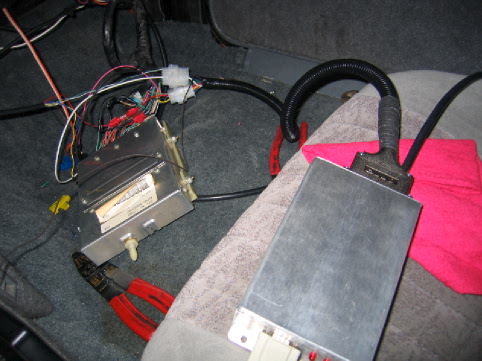

I just finished building my Megasquirt II V3.0 board. It is affordable and you plug your lap top into it to make changes to fuel and spark. The Megatune software that comes with it also has an autotune feature that basically tunes the car for you (target AFR per the AFR table that you can set). I also am new to programing, but if you take the time to read all of the literature, it is not too difficult. You can check it out at: www.msefi.com

When you did the MSII did you also buy the relay board, or are you going to wire up your own relays and fuses?
Old Jan 12, 2006 | 01:51 PM
Blown87's Avatar
Posts: 371
From: Chicago area
Car: 87 Z-28
Engine: 383 HSR w/supercharger, AFR heads
Transmission: 700r4 w/2500 stall
Axle/Gears: 3:73
I did not buy the relay board. I already have TPI on the vehicle, so I am going to wire it in right off the existing wiring harness. The factory harness has the relays and fuses needed for protection.
If I were putting this on a car that did not have EFI prior, I would utilize the relay board.

I have a 20 pin connector that I will be using to attach the MS to the factory harness. So, when everything is done it will just plug into the factory harness. I will have the MS controlling fuel and spark, but I am keeping the factory ECM functional so that my cooling fans and TCC still work.
I ran into a small problem with the MS which has stalled me a few days on the install. After assembly, the instructions say to wash the board in order to remove the excess flux. Well, after I did that I was getting very erratic readings from my IAT sensor. After some diagnosing I determined that the embedded code somehow was damaged. After reinstalling the embedded code and recalibrating the AFR tables, the MS now works porperly again. I plan on installing it in the car a firing it up this weekend.

Blown87, can you post a pic of that adapter you made?
-Dave

Blown87, I'm interested in the pinout routes you did. And I take it you were running MAF and switching to SD?

I was not clear in my previous post. I purchased the wiring harness for MS from diyautotune.com for $60. That harness plugs into the db37 connector. The 20 pin connector then connects from the MS harness to the factory wires which I cut, installed terminals on and inserted to the connector. I just did that because I do not like the idea of splicing and soldering each wire from the MS harness to the factory harness. Plus if I decide to remove MS and use it in a different vehicle I can just unplug it and plug back in the factory wiring. When I get pics I will post them.

Hey guys. Here are the pictures of the MSII install that I promised. This is still a rough install, I will refine it later. The scotch locks on the factory harness are no longer used, I just used them during testing the MSII. The wiring harness coming in from the left is my wide band O2. I am still runnning the factory ECM to control timing. After I learn how to tune fuel properly, I will switch timing control over to the MSII and remove the factory ECM.
Since I cannot piggyback the coolant sensor, I had to dedicate it to the MSII, which means I now have no cooling fans. To fix this I have ordered a Nordskog Pro Series digital water temp guage, which has a programable output control. I will used this output to control my fan relays. As soon as I get the cooling fans working I will begin road testing.

One more

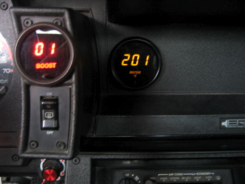

Thanks for the advise, but my coolant guage does not work, so I need to replace it anyway. By using the Nordskog I can fix my coolant guage and solve my fan problems in one shot.
It's easy, just five wires and I will have total cooling fan control that I can adjust at any time from the driver seat.

Here is the guage. I can now start road testing.
P.S.- wgripp, I apologize for highjacking your post.
