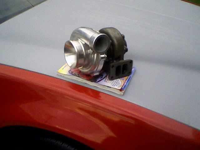

Looking back I wish I did, would have been a fun street car. Wound up getting two of these ebay turbo's, but then sold them to another member. Time freaking flies...
