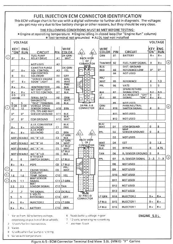

I had the great idea to hook up my jumper cables wrong and fried my ECM. PIN 16 is fried, Im getting constant fuel pump and headlight motors with power applied, and I keep blowing the fusable link to the alternator, with the injectors not firing.
The ecm I pulled was a part number #746 with a ANTT 8026 PROM in it. I actually question if a prom swap was ever done to begin with. It always stumbled at idle a bit, and seemed to run a bit lean. This makes me question if any of the proper steps were taken for this swap. Is there a way to tell if my injectors or injector pod was changed? Knock sensor? ESC module? PROM?
The swap was done before I bought the car so Im unsure exactly which block it is. I verified its a 5.7, but thats about all the info I can get off the casting marks.
Either way I think i need another ECM. Ive inspected wiring the best I could and didnt find any shorts, but I still am a bit worried I I may plug in a new ECM and fry it.
Any thoughts?

Before you plug in a new ecm you can check your power and grounds.
