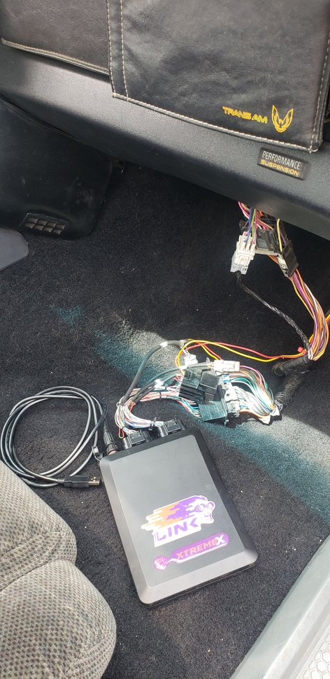

We make them to order. There will be a page on my car (86 Trans Am) that's currently running the adapter harness to the 7165 ECM up on the LINK website as soon as the webmaster in New Zealand gets it finalized. Here's some pics of it installed before I tucked it back under the dash:
This harness includes the ignition bypass relays to control the stock TPI distributor (large or small cap), and only requires swapping the MAF out for a MAP sensor (GM 3 bar, or whatever you like), and bypassing the external knock module (two wires joined at the module connector). It's literally 5 wires and you have a stand alone. Of course the LINK is capable of a LOT more if you want to add wires for full sequential injection or COP ignition with crank trigger wheels, etc. All of which is available from a number of sources.
Benefits over stuff like the Holley and FAST systems:
  • No re-wire. Uses stock harness and distributor.
  • Lifetime warranty.
  • Easy tech support - no hold queue with a different "agent" every time.
  • Myself and the VP of LINK North America are available for remote tuning (on your local dyno, or for startup in your driveway, etc).
  • 1 hour of remote assistance to get you started and idling included with all our packages.
  • Full stand-alone capability. Change any input and output to do whatever you want.
  • Turbo and supercharging, Nitrous, Meth injection, etc......
  • Closed loop with hyper accurate LINK CANBUS lambda module. No more failed LSU 4.9 sensors and no sensor grounding problems with analog stand-alone wideband controllers
There's lots more I'm sure. We can do a harness for the 7730 also but so far we haven't found a source for the blue connector header so we have to cannibalize them from old ECM's (not that big of a deal - they are cheap used).
