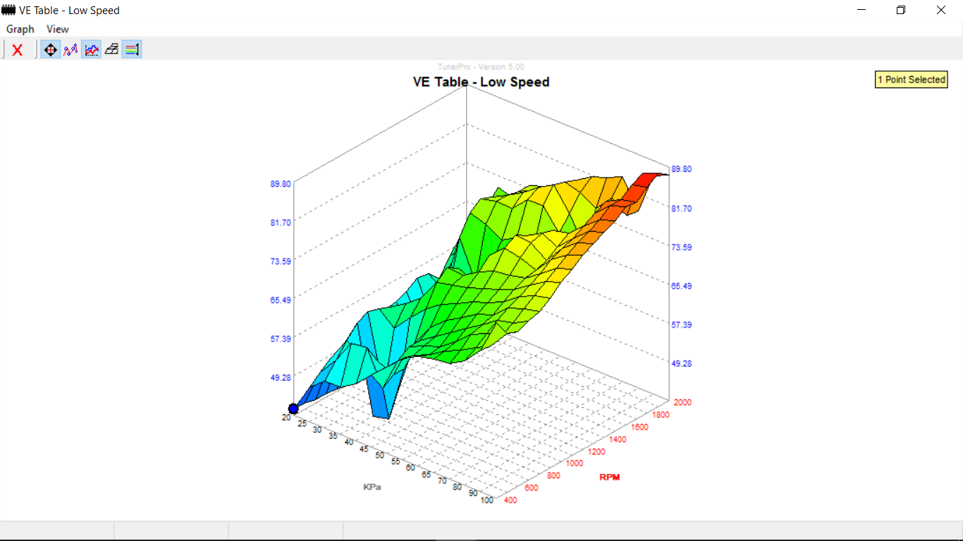

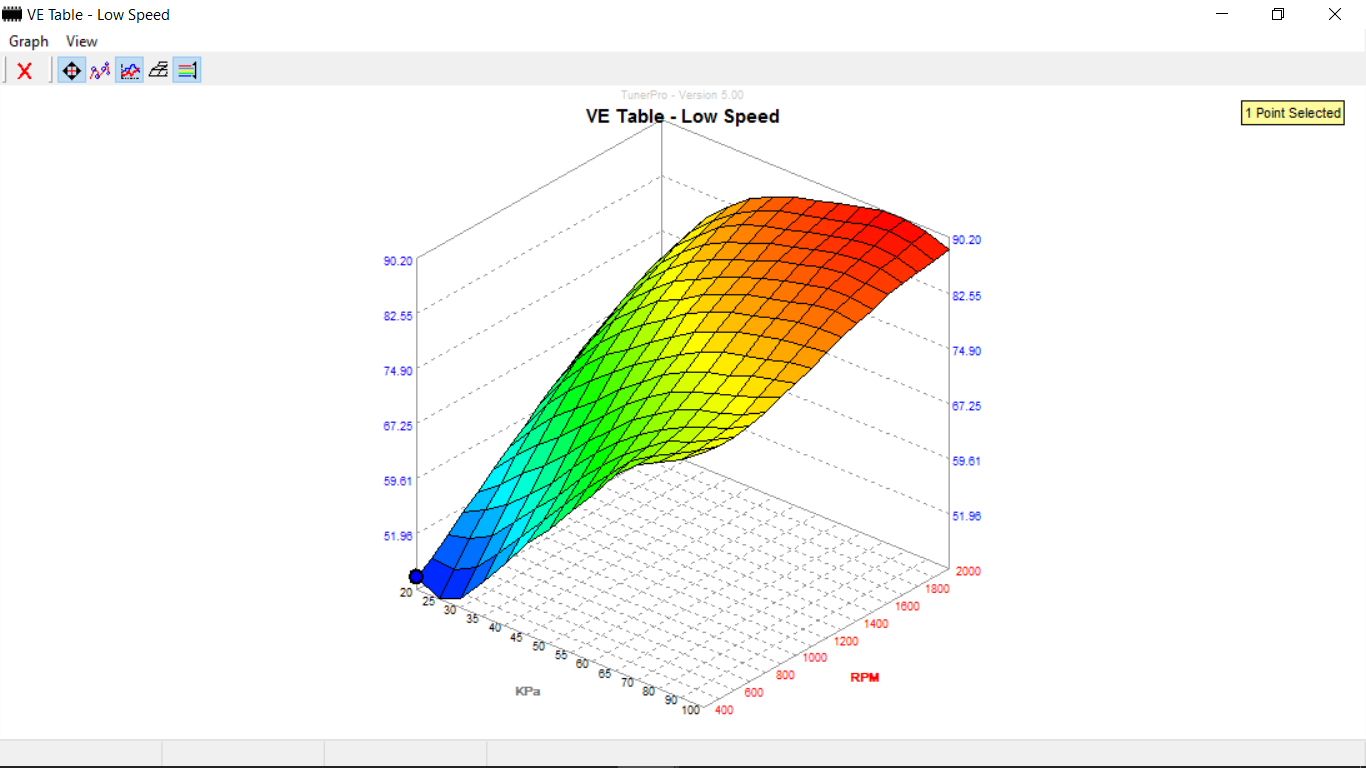

Old May 17, 2021 | 10:52 AM
  #117
Street Lethal's Avatar
iTrader: (16)
Joined: Jul 2003
Posts: 10,538
Likes: 206
From: NYC / Jersey
Car: 1990 Trans Am GTA
Engine: Turbo 305 w/MS2
Re: EBL and tuner pro
Rodney, let me show you, as well as the others who are watching so you'll digest what was done. The very first Crossfire Bin you uploaded into this thread before we even got started looked like this, see below;
Next, gave you the LO5 bin, see below, which was smoothed just a tad, so we can see where the fuel trims would be at idle.
... I mentioned earlier that the datalog will have the final say, and it did. Your BLM's were reporting 108 at idle, which were pegged rich. So now we'll start trimming the fuel down to where it needs to be. I only pulled about 4% of fuel from the VE Table, then smoothed it out, but you will see the difference in the values on the chart being used, see below;
Once the rest of the Bin has been looked over, I'll send you the next one to be Flashed in. Then wash, rinse and repeat in terms of data-logging. Just send over another one, or if you digested what is being done, it's just the matter of pulling fuel to accommodate your fuel trims, just don't pull too much in the lower areas. However I do have a question though, how do you have your IAC hooked up because I am not seeing any feedback in the diagnostic screen?
- Rob

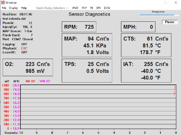

Sorry to interject, but IAT and IAC are easily confused. The CrossFire cars don't have an IAT (intake air temperature sensor). So it will default to the (stock) 40°C/104°F value. Can get rid of the SES/CEL by clearing this flag:
Malf Flags - 12 thru 24 - Bit 1 - IAT23
RBob.
Old May 17, 2021 | 03:17 PM
  #119
iTrader: (16)
Joined: Jul 2003
Posts: 10,538
Likes: 206
From: NYC / Jersey
Haha, that was a typo on my part, as I am so used to writing IAC. But yes, that should read IAT not IAC, see image below. Bob, thanks for clarifying the IAT issue, was honestly unaware that the Crossfire's were not running any...
- Rob
