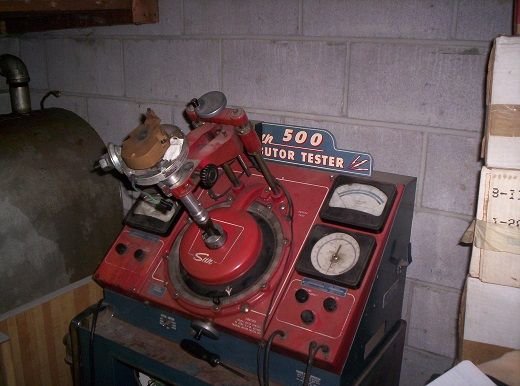

I'm before the days of HEI's. I was the guy who knew how to set up dual point distributors on the Mopar street racers I knew back in the day. Electronics were just coming of age.
I practically lived on the old Sunnen Distributor machine. (And still have access to one should the need arise).
