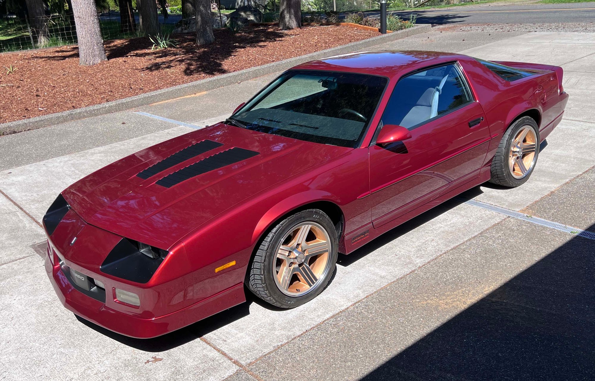

Thought I would add on to this thread rather than start a new one.
I have a 1989 LB9 T5 G92 car. It is all stock except air injection and pump are removed. The second owner installed headers, but the third owner did not like the headers and installed cast iron manifolds, an EMI dual cat and Y pipe (2 1/4"), Davico intermediate pipe (2 1/4") and a Walker muffler with tail pipes. None of it is mandrel bent and all are aluminized steel. The cast iron manifolds are not stock part numbers so not sure what they are from.
I plan on replacing this restrictive exhaust with a set of American Racing SS headers and connection pipes (1 7/8" to dual 2 3/4") then a Y fitting to 3" (no cats as I am smog exempt where I live). I plan on using Stainless Works 3" SS exhaust system with Turbo muffler and 2 1/2" tail pipes.
As far as I know I have a stock ECM (ANYS 9350). I'm sure a custom prom will get the best performance but will the stock tune be acceptable or at least safe for the engine?

IIRC, your LB9, M5, from 1989 was a stock 225HP engine if equipped with the N10 option (dual cat). I don't remember if G92 included N10. In any case, you are looking at 220-225HP max with stock set-up. With your proposed exhaust, that will certainly help the engine to flow better. But in my opinion, 1 7/8" is overkill, unless you plan later on cam/heads, intake etc... Expect to gain about 15-20hp with the improved exhaust. I had an LB9 improved about 30-35HP with shorty headers, primary 1 3/4" to 2.5" Y, to high flow single cat, to 3" combined with CAI, TPI foil, underdrive pulleys and custom PROM. In any case, it's a lot of money for not much now a days and it will be loud without the cat.
And yes, a custom tune will be way better. The original tune was most likely rich at WOT-PE (Power Enrichment), so it might compensate ok with you new exhaust.
But before anything, I would datalog to check if everything seems normal. I would you put a new 02 sensor first for good measure. FYI, the 02 sensor signal at WOT can give you a ball park AFR at WOT based on 02mv:
830 mv = 13.0:1
880 mv = 12.5:1
930 mv = 12.0:1
In any case, on your new set-up, I would install the 02 down stream near the header collector on either bank. That would be better, as long as you convert to heated 02 sensor.
Good luck

It will be safe, and it will run fantastic, compared to how it runs now. A custom PROM will get the best performance, but you'll get 95% of the benefits from the exhaust alone....and it'll run great.

Adding a heated 3-4 wire o2 will help retain closed loop. If it’s all stock 305 it’s probably running pretty good with the stock calibration. Can always datalog with $6e adx using tuner pro rt to see fuel trims.

Thanks for the experienced input! Starting around Feburary all 1989 LB9 G92 cars had the N10 dual cats. I think with the LB9 the only way to get N10 was to also have G92. I think all the L98 cars had N10 starting in 1989?
Agree 1 7/8" is probably overkill and 1 3/4" is more than adequate especially for a 305. I just thought the larger tubes were cooler looking but there is something to say for exhaust velocity when tuning headers so maybe 1 ¾” would even perform better?
To be honest, my car is very original low mileage car and if it had the stock manifolds, air injection and exhaust, I would probably just keep it that way (Although I really don't like the noise of airpumps). I may consider finding some stock manifolds and plugging the air tubes. I think both the LB9 and L98 use 14094063 and 14094064? Then I would install this Y pipe: https://www.hawksmotorsports.com/82-...nifolds-hawks/
Not sure if I also need the HO spacer on the passenger side for this Y pipe to work? I sent a note to Hawks to see what they say.
As far as adding headers, I was thinking to go through all this hassle why not?
In any case, I do like the idea of having a stainless exhaust on a car I plan on keeping for a long time.
