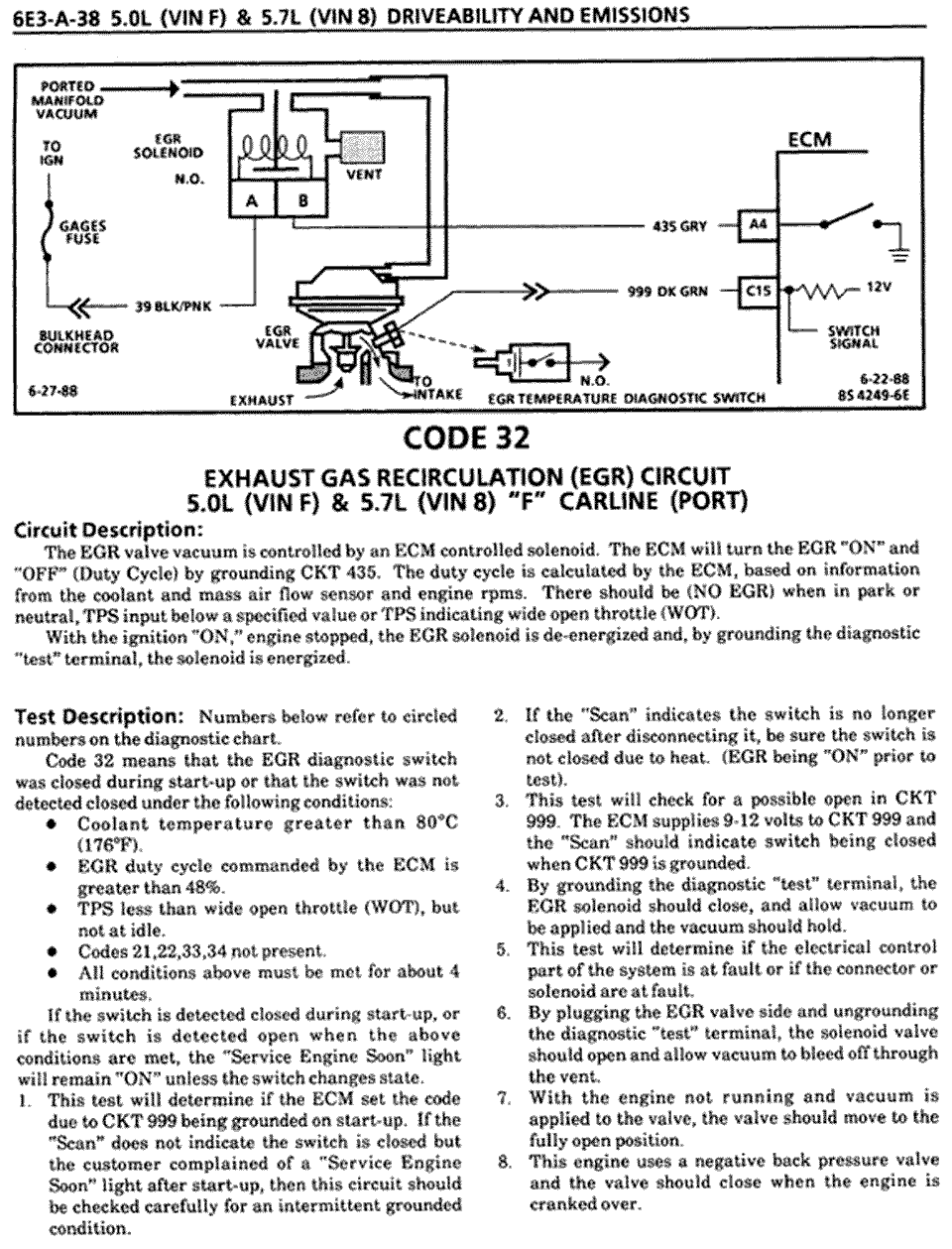

For the EGR, you should get a code 32 if you removed the valve. So yes you need your tune modified. Check with @Tuned Performance like @Reddragon88gta said.
See attached files for your info
