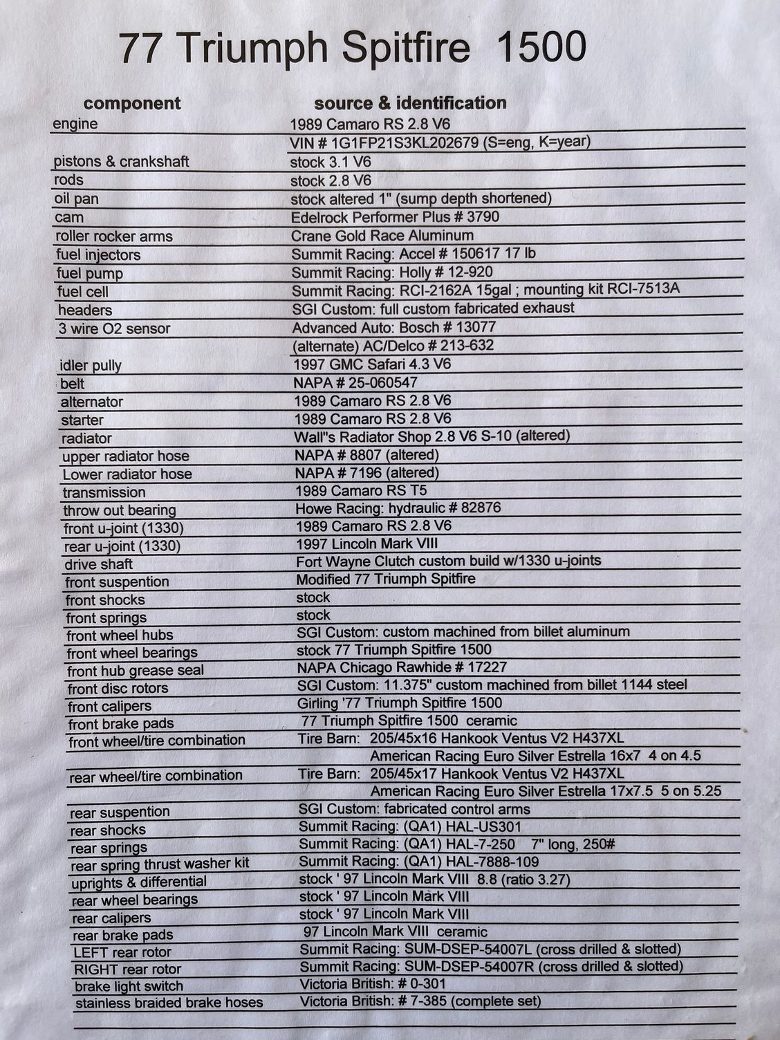

Hi Dudes,
I’ve read dozens and dozens of threads. I have a Frankenstein car. 1977 Triumph Spitfire with a 1989 Rs 2.8L and tranny swap. This car is fun, but I want more. I’ve reached out to numerous shops to help tune but nobody will touch it. I’d like to look at tuning since I think everything else has been done. Build sheet below.
How do I know if I have a stock MAF or a conversion?

Look at the maf for any bosch part number. I would guess the ecm is service number 1227302 numbers. If that’s the ecm then the maf is from 86-89 2.8l v6 f body.
looks like I’m stock. The Bosch # is 25007557. I am VERY interested is this conversion. This update and a tune is all this car is missing (albeit boost maybe in the future). I’m SE MN, about 3.5 hours from Dynamics dealer in IA. Has anyone used them before? Anyone here from the MN area worked with a reputable Dyno place?
