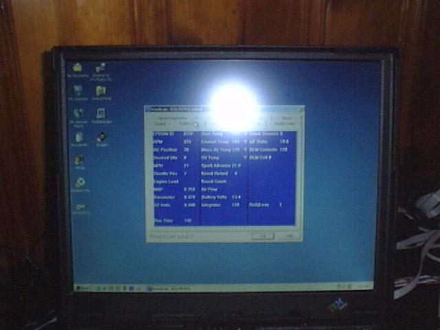

Simulates most sensors (knock and O2 disabled) and displays the major ECM outputs via LEDs.
ALDL to Serial onboard, just add serial cable.
Size is roughly 4 ½” by 8” . Will fit into an old P3/P4 ECM case.

I just finished one for a freind (730) type, works fine with Craig's software for the 730 and with FreeScan for the $58. I need a 165 to final check a MAF setup, but it should work fine.
