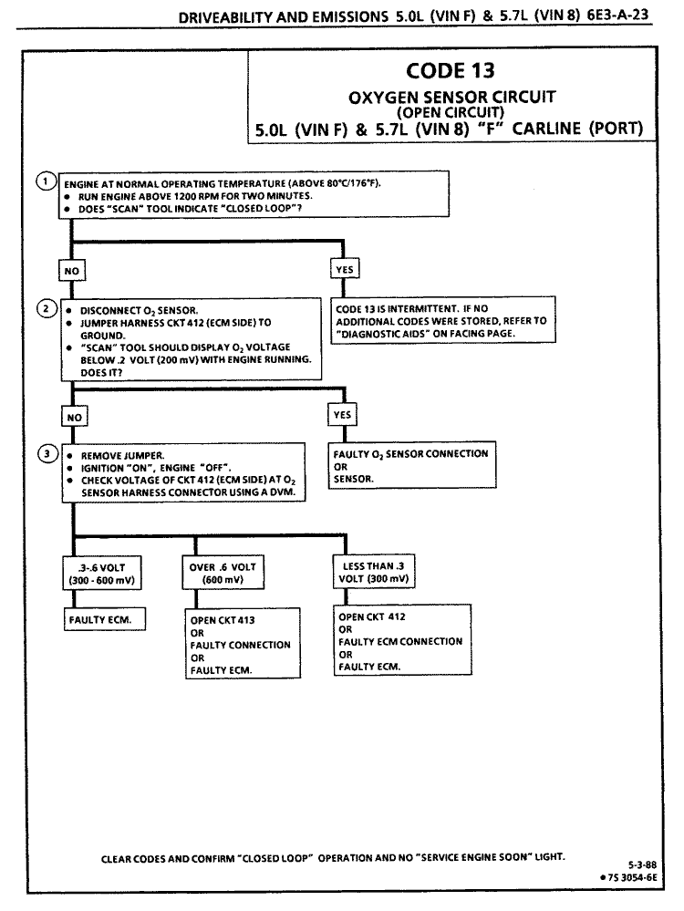

Maybe this chart will help you in troubleshooting the problem
Attached Thumbnails O2 Fail, Error Code 13, but good mV and Xcnts-code13tpi.gif

Hi Trickster,
I will use these diagnostic cards.
