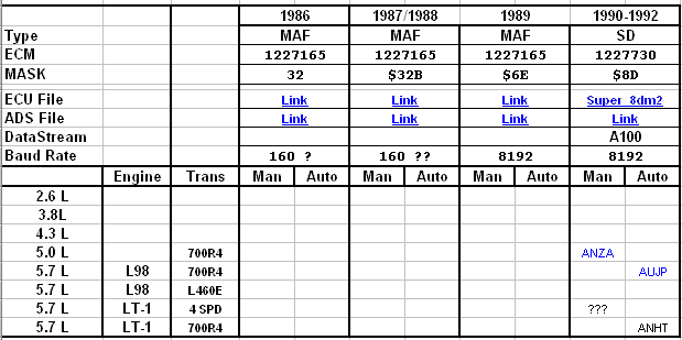

Originally posted by MTPFI-MAF
ok Tim here is What I think the INTRO should contain.
In This Order
-A Explnation why You Should Burn your own chips and Not buy a Aftermarket Chip. (CaptPicardsZ28) has a Nice Post that should be used
-How to tell what ECM and Mask You Have
-Explantion Of what is a Mask, Bin, ECU, Data Streame Definitions With links to Them.
-Explantion of Why you Need to Scan With Step by Step Walk Through To scanning (With Screen Shots) and software Recomemdations
-Diagrams on how to build a Cable. Links to ALDL Cable Sellers
-Hardware Selection, Programmers or Emulators. Chip Adapters, ECT.
Like Tim suggested Lets Concentrate on a informative Easy to understand INTRO, I also would like to say that some of the problem I had when learning this is too many software choices, I think it should be narrowed to: TunerPro RT, CATS tuner cat for Bin moddifying and TunerPro RT and Moates ECM852 for scanning.

The existing article was written in a manner to keep it as short as possible (believe it or not). The basic question that people want answered (newbies please jump in here and let me know if this is still true!) is "How hard is this?". We need to answer that question before jumping into all the rest of that stuff. That's why my article basically begins with "What you need?". I broke down the article into Specific sections. The existing sections are ...
1) Disclaimer
2) What you need...
3) How you do it...
4) How difficult is it?
5) Important information for beginners
6) Modifying the BIN
7) Scan Tools and Wide Band Oxygen Sensors
8) Newbie Questions
9)Detailed related stuff: How EPROMs work, EPROM Reference for TPI and TBI Thirdgen F-bodies
First and foremost lets decide if this arrangement is appropriate and what needs to be added. I totally agree with adding your first section "A Explanation why You Should Burn your own chips and Not buy a Aftermarket Chip". Awesome. But, I wouldn't jump into masks and such right away because it is just going to be confusing to a newbie. The end question is ... WHAT do we put after that?

I think the existing sections 1-4 are good, to start with, along with the first part from MTPFI-MAF(CaptPicardsZ28).
When you get to section 5, thats when I think you want to start blending together all of the ecm and mask details, because, at that point, you're like, OK, I know why I want to do this and it seems reasonable, now how do I start with MY car?
so for example, in section 5, point out the different styles of control(MAF/MAP), and how to find out what your car has(ECM, components). introduce the concept of code mask and the BIN.
basically, start out with some general stuff, then dig down to give a little more detail. not all though, thats what the part 2's will be about.....

any ways I have this Chart that Tim made and I modified it for the bin editing page. If you could help me fill in the blanks with links to functional ECU files and a good Starter Bin would a real Help.
Remember Starter Noobie BIN. (STOCK) and the correct ECU
I will eventually find everything in Due time just trying to speed things up a little. Thanks

You may need more blocks under the BIN area to cover different engine sizes.
The AUJP can go for the 730 "Auto" section, but I don't know if you want to use a single bin for the mask and instruct that the constants must be changed for the engine displacement.
Most people are running either 305's or 350's for the most part.
Those running 6's may feel left out.
It could branch off and get large in a hurry if you try to include everybody.

Well Shoot I forgot that people With a AUTO Trans could have 305 or 350 where people with a FACTORY 5-speed had only a 305.
Hmmmmmmmm any suggestions!!
Well I ordered a ANZA memcal and have personally read the Chip, Disabled Vats and burned it to a prom for my Stock 85' LB9 and it Starts and Idles, and I know that Mark has a copy of the Stock ANZA Bin on his web site so it is available for download, and I used TunerPro difference tool and His ANZA matches the stock one I read Exactly.So I figured this is a good $6E 5-Speed Starting point. Guess I will add a 305/350 option for the automatics in the chart. and may be I can talk to Mark or I will change the Injector Constant on the ANZA for those who swaped in a 350 with a 5-speed and call it ANZA5.7 and Make it availabe for download.
So what ya think
So what ya think

Good to have a manual bin, I've seen a few posts asking about a good one to start with on an $8D.
As far as the tables go, IMHO It would be best to stay with completely stock configurations.
The changes as you have for that bin will add confusion to someone that does not realize the combination did not exist from the factory.(if it did then make room somehow)
Then the spark is lit for them to investigate the possibilities and explore. Then somewhere a link to a new page with another chart and the sites with all the "modified" bins.
The table arrangement looks good. If you can add maybe ENG to the left side and insert rows under the AUTO and Manual headers it should leave a way to include just about everything out there.
Do I want to mention N/A or S/C, Turbo ?

Still more options!
It started expanding as soon as I added a few items.
The engine and trans stuff gets big quick. This may handle it (or something similar)
Of course not all items existed, but there's room for freaks of nature

Well I have had a little time to work on it, Now I think I have writers Block. lol Well I TEMPorialy put it on the web so that you Guys can look at it, and give me Ideas of what and where to go and do with it next... Yes there are popups on the Site but when this is Done It will be hosted on TGO server I hope. Thanks
http://www.f-body383.100megsfree5.co...PromHeader.htm
Now you should have a Screen that Looks like below see where it says Definition File, Click on the Button and Select "you" ALDL Definition File or as it is "know" to TunerPro your .ADS file You will need the Proper .ADS file for you application or Things Won't make since. Go to TunerPro ALDL Definition Download page to get a .ADS file for you Application.if you don't see a .ADS file for you application there please refer to the chart here to find it.
Posts: 9,962
From: Moorestown, NJ
Car: 88 Camaro SC
Engine: SFI'd 350
Transmission: TKO 500
Axle/Gears: 9-bolt w/ 3.23's
Also will the same 2 transistor Cable work with $4D $61 I know that they are only 160bps.
anyways if people with $4D and $61 lead me to .ADS and ECU files that they use and Know are correct.
I can redo my ecu for the $4D and submit it. I had an old one but it kinda sucks. I finished my disassembly of the $4D like 8 months ago so the ecu is long overdue for a revision.

Don't forget to include the replacement '8259 for the '7165. the newbies will get confused real quick when they don't find a '7165 under their dash.
Joined: Apr 2004
Posts: 3,180
From: Browns Town
Car: 86 Monte SS (730,$8D,G3,AP,4K,S_V4)
Engine: 406 Hyd Roller 236/242
Transmission: 700R4 HomeBrew, 2.4K stall
Axle/Gears: 3:73 Posi, 7.5 Soon to break
Actually that threw me at first as well when I kept seeing different numbers for a 7730 being reffered to as "the same thing"
There are three part numbers for the 7730.
You could just make reference to the BCC page you have linked to make the reader confirm the part number they have there to be sure.
Looking good BTW, anything new going with this?
