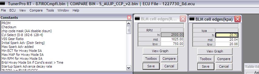

I swapped from my 808 to the 730 ecm on saturday, and am starting to play with the tuning aspect of it.
I am looking at the blm cell edge tables to try and get them closer to what my car runs. RPM table is great, I can see exactly what I need. kPa table is different though. The values don't reflect what they should at all. A couple other blm tables are this way as well. I'll attach a screenshot of what I mean.
Is there a special conversion formula I need to use with this?
I compared the item location to what is listed in the hac, and it's dead-nuts on. But I don't have the knowledge yet to actually go in and verify the ECU myself, so all I can go off of is the hac.
You can see the ecu and bin I'm using in the titlebar of the screenshot. I've tried it with all of my 8d ecu's, and many bins. All of them are identical.

Not sure what the issue was, but I found an ECU that works. It was bundled with some superaujp stuff on moates' site.

Go here http://www.supportfitness.com/mark/t...oadBinDefs.htm and get the Super_8dm2.ecu file from Marks site.

That's the exact one I found, seems to be the most complete by far too
Thanks
