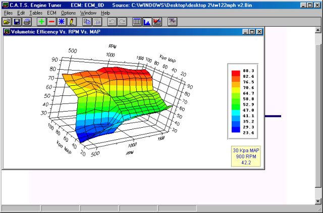

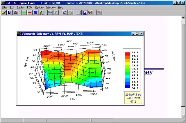

Someone asked what the VE Tables would look like between say a Holley Stealth Ram on a ZZ4 with a Hot Cam vs a stock TPI setup.
Here is a graphical comparison between the two.
The first is the stock TPI

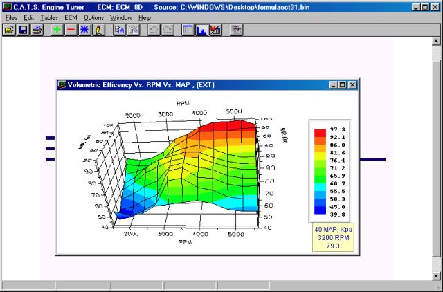

And this is what a ZZ4 with a Holley Stealth Ram with a cam around around 218-222 I/ 224-230E @ .050

Great graphs to show. You can really see how the TPI setup is tuned for that toque peak made from the tuned runners, and how it is so low everywhere else.

Cool beans baby....that HSR graph helps a lot. I am getting another cam soon and I will have to make adjustments on the VE tables. Thanks Glen. How high do the numbers go above 4400? Mine top out at 99.6@ 80% throttle. I think that's kind of high.

Thats one thing I love about SD is that the VE table really gives a good idea of what the engines torque band really looks like and how changes are effecting a setup.

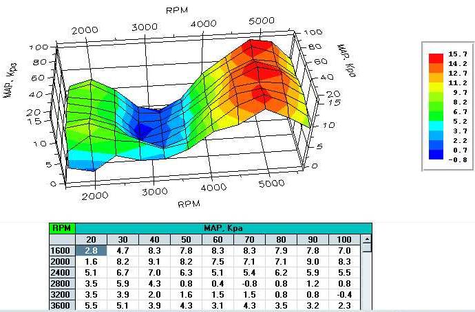

I wish I could "overlay" these graphs (rather than just show the difference", so you could get a proper sense of "perspective".
TunerCat "colors" the graphs from "lowest to highest", but the "lowest" on one graph may be almost as high as a peak on the other graph.
The TPI graph has a much lower "low point" than the HSR graph. The TPI Graph has a range from 52 - 82, while the HSR graph has a range from 60-84.
And the "value of the 100 kpa@5,600" between the TPI graph and TPI/ZZ-9X combo show the same color, but the TPI/ZZ9-X is higher numerically...they just look the same base on the "color range" of TunerCat.
But it sure would be nice to do an "overlay" or have the "color range" the same kpa values for the two graphs so you would see one as almost entirely red, while the other was almost entirely blue. Maybe I'll ask Tunercat to consider it as a future revision.

To keep on topic here is a comparison to my lower ve table. It's from my 406 w/ stealth ram, 242/250* cam,30lb injectors, ported world products iron heads, 1-5/8 shortys...

I'll first post both the VE tables from my formula. I'll cut and paste the mods. I would also like to add that my torque peak is at 3400-3600rpms(confirmed on the dyno). This is the car that has the 10" 3600rpm non-lockup stall. Here's the other info.........406 w/ stealth ram, 242/250* cam,30lb injectors, ported world products iron heads, 1-5/8 shortys, 11.3 CR, flat top pistons....
here is the lower ve hopefully from a better angle. You can see the idle spot by the "hole" in ve graph(850-900rpms X 60-70kpa). It's leaned out that much for two reasons, 1. to get rid of the nasty exhaust smell, 2. because my fuel pressure is raised at idle due to large cam and decreased idle vacuum. Right now idle a/f is at 15.6 or so....
Now for my friends 383....t56, l98 heads, GMPP cam 234/242*, miniram,38lb ijectors, 1-5/8 long tubes, at least 11.8 CR and a few other things. His car use to run 107-112mph with a custom hypertech chip. I finally talked him into letting me burn a chip for him. I've been at it for a year now and it has ran a best of 122mph on my calibration(no hard parts changed aside from 1:6 rockers).
feel free to ask questions on why I made them that way...
Also have a SD bin I did for another friend if you want to look at that. It's a 355 with aluminum l98 heads, siamese runners, hot cam...

Do you have any wideband datalogs of that mini-rammed 383? That VE table confuses me unless you were tuned ONLY the VE tables and not touching the rest of the code. I can't believe that the setup has 3 tuning peaks, one at 2000rpm, another at 3400, and a last a 5000. You also have it "inverted" with different manifold pressures... again confusing me.
I understand the large cam is a tad funky but I just can't figure out why you'de ever remove fuel when the manifold pressure is higher. Could you explain you're tuning method so I can disagree more

Maybe its got VTEC. I thought the same thing but I guess if it turns in good results, AFRs, and times at the track it doesnt matter.

FYI, the 95-100kpa areas in the ve tables I posted look messed up because I used afr tuner to tune WOT. Instead I should of adjusted the ve tables in those areas, then used afr tuner...
It also looks like AE was being tuned into your VE tables instead of with the actual AE tables.

11sOrBust, I really think your VE tables have a lot of AE in them. Looking at the lower VE you appear to jam a bunch of fuel in at the high MAP area's which can do 2 things, one it can be the same as your delta MAP AE or it can be suppresing too much timing from showing it's ugly head.
As for the upper VE table, the higher the pressure the more air, it's a simple equation. The rest of the curve depends on pumping losses and throttle body angle. Neither of which could cause your VE to go DOWN as it does.
My feeling is if you trimmed that VE table so that the value at every RPM increases based on MAP, and then you decreased the lower RPM high load areas, adjusted your AE to shoot more fuel in, you'd have a "scientific VE curve". Again, this is only how I'd do it because I love tuning for perfection. Some do it to tune the motor only in it's opperating ranges. Different styles.
