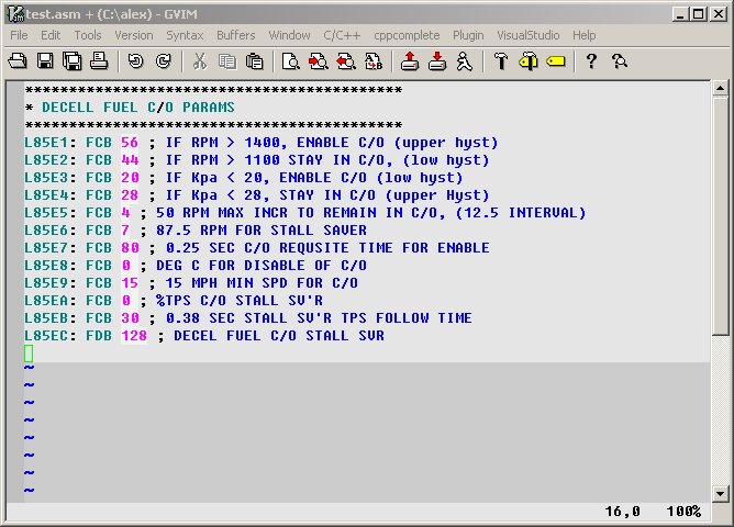

I GOT IT!!! How about this;
Replace the shorthand with real words!
LDAA replaced with Load into A
CMPA replaced with Compare A to
BLS replaced with Branch if A less than
I know this is done in the hacks but it would be nice to have the assembler recognize long hand.
This way you can read the code outloud and it makes sence to other people, not only you
I love Visual Basic more so than C++ because it's so flexable and the code is written closely to how I think to myself. Having less { } and declerations, no colors, no help and lots of shorthand make for a very steap learning curve.

Woah... that is colorful.
I guess the whole idea behind the pneumonics is that its a short abriviation for what the machine code represents and it allows you to quickly type the commands. It would be nice to have it recognise each. That way you can either type it out, or if your in a hurry, just type the pneumonics.
I dont think the pneumonics are any worse then people typing IMO, IOW, PW, CAI, etc. Some of all of those stupid abreviations took me awhile to figure out. At least no-one around here uses AIM speak. 'I nd 4U 2 help me l8r' Man I hate that crap...

Alex, What is that pretty editor you're using? And where can I get a copy?

I'm glad to see this finally going somewhere! I just looked at one of the first posts that Bruce made, and it was back in 2001.....3 1/2 years ago!
JP84Z430HP, it's called vi, and it's available from http://www.vim.org
It's a very powerful editor, but it's got a steep learning curve. You don't really need a mouse for it, all of the commands are available through the keyboard, ie to delete 3 lines you would type 'd3d' etc. I've been using it for about 5 years and I still don't know it all.
Give it a try, but be sure to read a tutorial on getting started, otherwise you'll get frustrated with it. I did the first time around, but after I watched other people use it, I came back and learned how to use it properly and never looked back.
