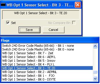

I'm still having trouble with my scanner. Attached in this post are my settings. I have the pin set to come in on F14. I went to scan the sensor, and all that was returned was the value 12.00V with no change in that value with RPM or anything. Any suggestions?

Check what word 37 in the constants is set for.
It should be $0035 to show afr.

From: KS
After i apply the patch to my .bin, would this be the correct memory location to change for the FJO non-linear wideband? Any help appreciated.

JP86SS's Avatar
Joined: Apr 2004
Posts: 3,180
From: Browns Town
Car: 86 Monte SS (730,$8D,G3,AP,4K,S_V4)
Engine: 406 Hyd Roller 236/242
Transmission: 700R4 HomeBrew, 2.4K stall
Axle/Gears: 3:73 Posi, 7.5 Soon to break
Looks good to me
$2000, bit 1
Should be good to go if your wiring into the default pin and your sensor output is correct.

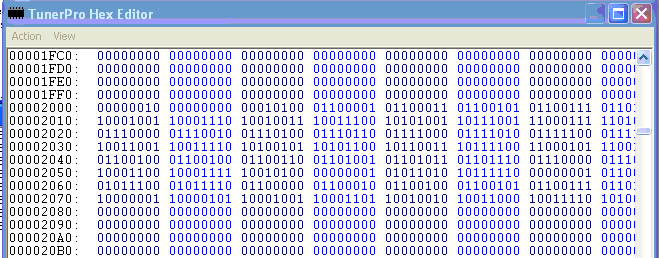

92Z
Posts: 278
From: KS
Thanks for the quick reply. I just patched the .bin. Looks different than original so i guess its good! I am by no means a code man at all. But with the help and support of the people like you and the Thirdgen PROM community i am learning more and more everyday. Thanks again!!
