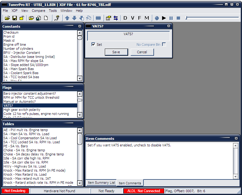

I am working on a 92 TBI Camaro and can't find a ECU file for the $61 with a switch to disable the VATS. Can someone tell me which Hex location to change and what to change it to to disable VATS.

Tried that one with Tunerpro, but I am used to playing with Tunercat and having a enable/disable checkbox. Couldn't find anything that specifically said VATS disable in that def. file.

Hey, thanks. I was trying to open it with an old verison of Tunerpro I had downloaded that wouldn't open an .xdf file. The file I had was a .ECU file that only had "Options @ ?" and "Diagnostics @ ?" in the flags section. l Opened the .xdf file in new TunerproRT I had and it works.
