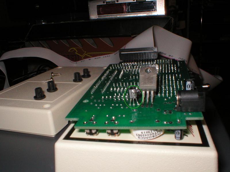

Problems with PPII while programming 27SF512
I was using my PPII to program the 512s and it worked ok for awhile, but suddenly a transister literally just totally burned up. It was so badly overloaded that it really heated up the power supply as well. The chip itself appeared to be in correctly and wasnt noticably warm compared with the burner, which would have probably caught fire eventually. The kicker is that other then that burnt transister, everything else is visibly in perfect order. The transister is located on the underside near a v-reg and feeds into what appears to be an xformer. I assume its used to generate the Vpp.
Has anyone experienced anything like this? I emailed xtronics, but am still awaiting an answer. Im just curious if its something thats happened before.

Got a picture of the damage?
I burned off a transistor from the main board by hooking up the power supply polarity reversed. Who know Xtronics wasn't standard center pin positive .

That looks like the power transistor that I fried off the board when I reversed the polarity. Looks like you need to replace it . Any chance you've been using one of those RadioShack "flip tip" power supplies? That's how I broke it.

It was the little no-name unit that came with it. Still puts out 9 volts at the right polarity under no load. I dont know how it is while under load, though.
Replacing it is easy enough. The question is: is there anything else damaged?

Or it was a poor design. Serious damage could have resulted if I hadn't picked up on the smell of burning plastic. The transistor got so hot that it burned off the board in about a second and was burning it's way through the plastic case! Poor design, great product when you follow the directions . You can only expect it to have been a weaker design by the price. Compare it to those expensive programmers and the only thing cheaper are the DIY kits, Imported copy cats, and the Burn1 but none of them are as flexible.
I hope for your sake that only the transistor is damaged. They're cheap enough to replace even if the 2nd one blows.
