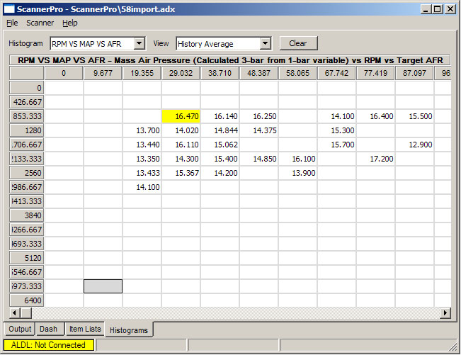

Here's an image (a peak of sorts) of the test app, which will be released as a stand-alone datalogging and monitoring application. After I release it, I'll integrate all features into TunerPro v5.
In this screenshot, you can see how a fuel economy item is defined (i.e. how output from items are linked to create a new item) and the results as outputted in a new analog gauge control I just finished yesterday.
This gives you a hint of some of the cool features of the new ADX ALDL definition format. It's as powerful as the XDF format is, if not more.
M

Originally Posted by junkcltr
Looks good. New file format???? ADX???
;-) Think XDF, but for data acquisition. (Yes, there is an ADS importer).
- new command types (listen for silence, listen for chatter, etc)
- command macros (link commands to other commands, etc)
- Item output linking (like the above example)
- constants (like the injector constant in the above example)
- calculated output can be passed to a lookup table
- string lookup tables supported (for things like outputting "High" if value > X)
- completely configurable histograms
- completely configurable dashboard
- completely configurable "list views" where defined items get added to a list view, bolded, colored, etc.
and more over time (I have lots of item types that I plan to add post-release, such as "state" items, where you can specify that a state is TRUE if MPH > X, load < Y, and overdrive == true).
Good stuff, and all working. I'll let you know when ScannerPro is ready for alpha testing.
M

Yah Mark has some killer stuff coming that is for sure. I checked out a version to see if I could get it to connect to the 749 (code 58/59).
I was playing with this nice little historgram I made when I got it to connect.
You've got to fix your axes, man! =) Also, I've since added 3D graphing for the histos.
I made that before you told me how to fix it and that was the only screen shot I made.
