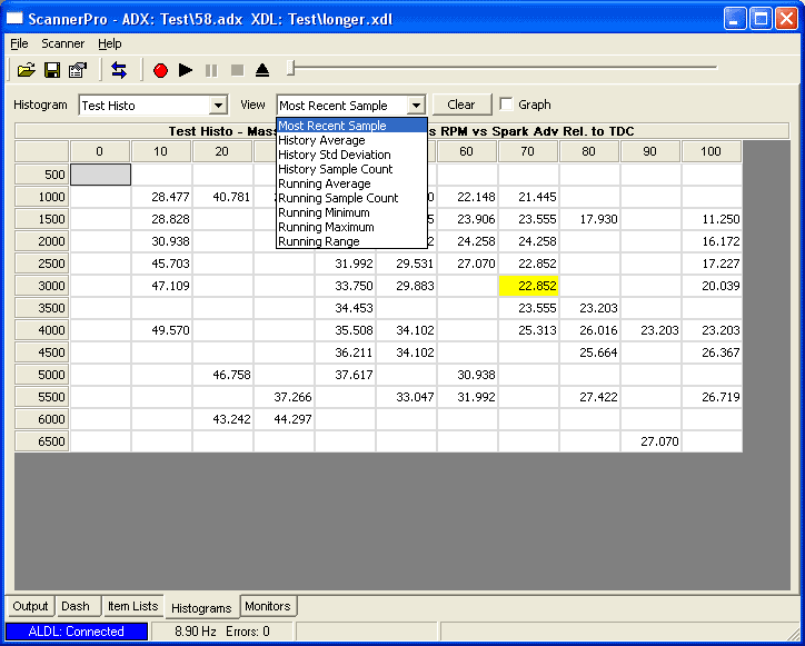

I'm thinking it's time to explain the delay in new TunerPro builds. I've set TunerPro aside for a bit to focus solely on datalogging and monitoring. The result is a new piece of standalone OBD monitoring software with all new features. I've written this application from scratch and developed it with the lessons I've learned in writing TunerPro in mind.

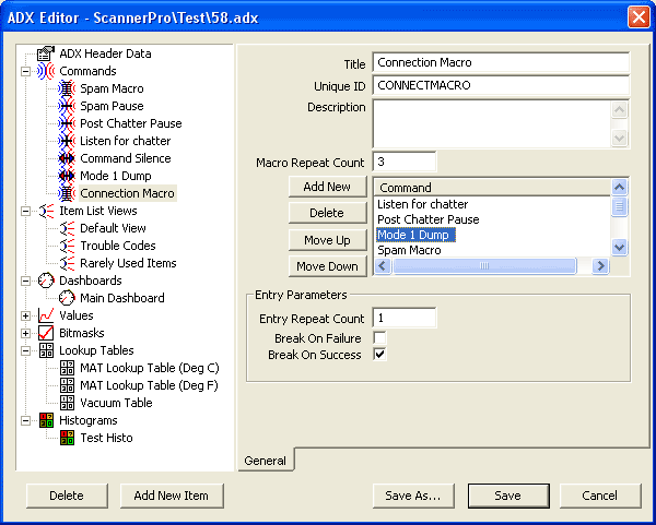

It uses a new definition format, ADX, that shares many features with XDF. Items can be linked to other items (for new data types such as economy, fuel correction terms [target AFR/WBO2], etc). You can define constants for other calculations (injector flow rate, vehicle weight, etc).
You can gather histogram data, with a definable history depth and various calculation methods including standard deviation, running average, historical average, etc. The active cell is highlighted.

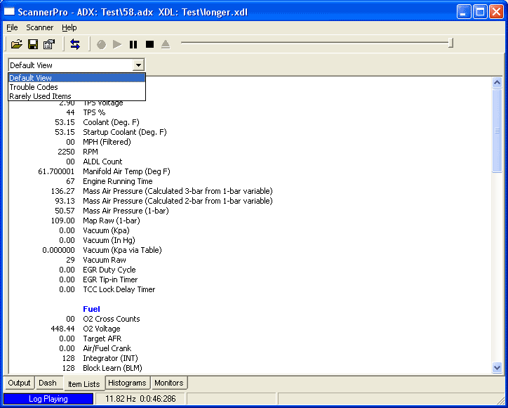

Item lists are completely confurable. You can add flags and values to the same lists, and define multiple lists. List text can be any color you choose with bold font or regular.

Commands can be batched in macros for doing things such as data dumps, complex connection routines (such as those required for $58 - my current testbed, and 94/95 LT1). Down the road you can also define BIN dump macros for ALDL bin dumping, as well as control commands for doing Mode 4 stuff.

Histograms:
Item lists:

The ADX definition editor:
