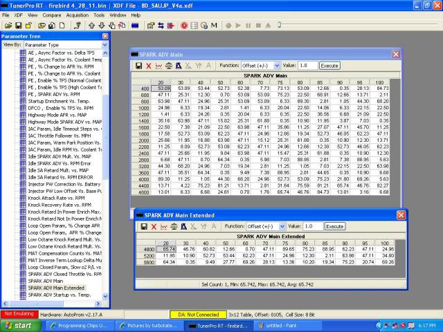

chip = 27sf512, 730 ecm , offsets 000000 -> 007FFF 008000 -> 00FFFF
what's up with this

Could be a bad write or issue during transfer.
Be sure to make the couple of tweaks to the definitions listed in this thread:
https://www.thirdgen.org/forums/diy-...-released.html
Had more to do with the extended VE table not the SA so this problem is unreleated.
Shoot me over your bin and i'll take a look at it and see if I can fidure anything out.

Try my V4 definitions and see if things look better.
You should also try the S_AUJP V4.
Same basis with a few added goodies and you can bring in the V3 settings for the throttle follower etc using the compare in TP.
Jp

still having issues.
i tried the v4 bin with a couple of xdf
some thing else i noticed is my timing is not
advancing when i rev the engine.
i am trying to look for common denominators
to solve this ...
any ideas appreciated

Re: what causes jumbled data
Holy bejesus!
that bin is FUBAR. I must have not had it "enabled" when I put it in the difference tool.
Take the original bin and begin transferring the good settings you want over to it again.
The SA table is certainly corrupt. No pattern just all over the place.
Even the cylinder select is 0C which is not an option.
(I take back my last comment, it could be this bin doing that because it is so bad.) Do not run with that, who knows what it will do.
Do you have a previous tweaked bin to use as a starting point?
i loaded a stock bin with just a couple of changes
and now i have timing control. still idles high .
it has error code 12 & 42 stored.
i am not sure how it got jacked up , the car used to
run awesome and i had not made any bin mods.
i need to log the car but i always have problems
in turner pro. i may just reload tuner cat .
