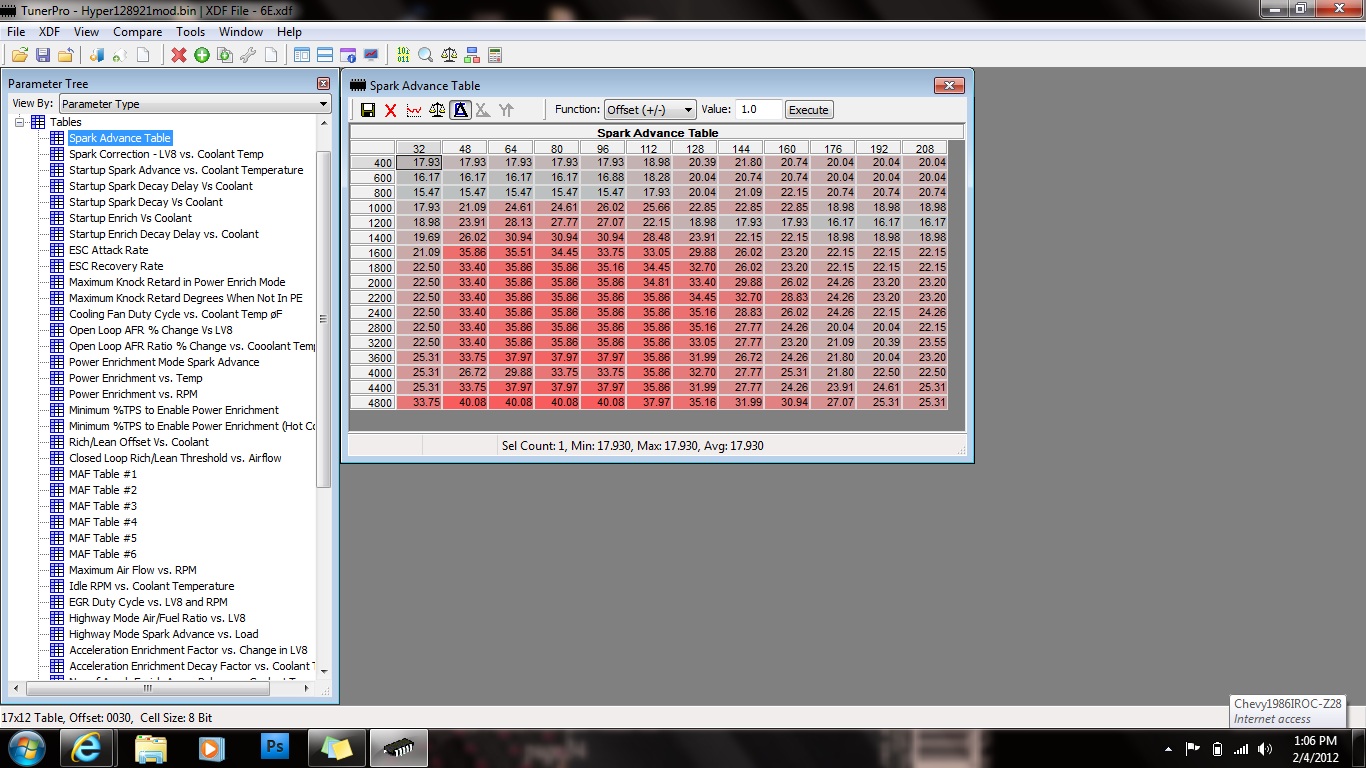

In other words, how do i replace this table below with another table?
IROCThe5.7L, is this the table that you are referring too?
Attached Thumbnails Need help changing data in 89 OEM bin file.-spark-advance-table.jpg

AAHHh. My apologies utilityguy2. I have my OEM 86 305 Memcal. I swapped out my bad engine with a 350 block. So thats why I have a 87 350 bin programmed into a EPROM. problem is that I dont like the throttle response. When I had the 87 Hypertech, the throttle response was CRISPY. I loved it. So I wanna modify my current EPROM to have the same CRISPY response.

Simplest solution is if you were happy with the Hypertech Bin, just copy the complete bin to your sst512 chip. You are going to get into trouble just copying some tables. fuel and spark all work together. But if that's what you want, you need to setup the compare bin and either use the function cpy frm cmpr or highlight entire compare table and copy to new bin. that's where you get into trouble. But, maybe Iroc can tell you more.

Thats the problem. I had the HT read and it didnt look good. Tables where all messed up. I would clone it if i could but its out of the question. Here is what the Spark Table to the Hypertech looks like below......
Attached Thumbnails Need help changing data in 89 OEM bin file.-hypertech.jpg

Originally Posted by tunedperformanc
Just looked I guess dyslexic am I !, You are right !! opps typo. Doing better every day man. we had 16 inches of snow drop overnight. can wait for winter to be over
dyslexic? Nah man. You just overlooked it. Lol. Damb. I wish I still lived in CO. My wife and I LOVE the snow. I hope I can find that HT 127062 MemCal. Even then, a ThermoMaster for the 89. Either one would work for me.

I thought that Hypertech didn't modify any spark until WOT? I don't think they touch any part throttle spark or fuel.
Old Feb 14, 2012 | 03:21 PM
utilityguy2's Avatar
Joined: Mar 2010
Posts: 486
Re: Need help changing data in 89 OEM bin file.
That's true on a Corvette bin so I'm guessing it follows for F body as well. Just a few degrees difference though. They seem to gain the most from lowering the engine temp from what I can see.

It is very likely low on timing. Try an ARAP.bin file but lower the timing some if you don't have aluminum heads.
When I did the chip to lower fan settings and such for you a long time ago, it was a ABWT.bin. Not sure how it was compared to the Hypertech chip on your car though. I can email you that .bin file if you want.

Well, if you are going with AFR 1040's, depending on other parts of the setup and compression and such, here is what I would do:
Forget the hypertech chip. Going with major mods like a great set of heads, you can't just plop a chip in it. You will need to tune it. Go with a stock 6E arap bin to get started. Set up your compare bin in Tunerpro, then compare alot of the other settings from your stock bin and copy them over into your arap bin. Like converter settings and such. Or, you may like the arap settings once you try them. Change your injector size over to the size of injectors you have, change your fan settings down to turn the fan on about 10 degrees higher than your thermostat temp, and off about 3 degrees above your thermostat temp. Set your WOT timing at about 34 degrees. Set all the other timing tables to 0, like the PE spark advance table. Leave some spark in the startup spark table, but zero all the other ones out. The spark table is what you see is what you get, so as long as your distributor is set for 6 degrees advance, the numbers in the main timing table are already taking that 6 degrees into account for you. Disable vats and anything else you don't need. Then begin tuning the blms and such.
Do you have a wideband? If not, you should get one. You are going to be making some power now, you don't want to go lean.
I'm assuming you already have the 6E.xdf file. I have some modified 6E .xdf files, depending on how far you are going I can send you whichever you want. What I mean is, you wouldn't want the one that datalogs a wideband if you aren't going to hook it up because it will mess up other things. I have some that have some other things in that are sometimes helpful to edit, should you ever need them. I'm sure the standard 6E.xdf is good for you for now. I can email you a stock arap.bin if you want also. I unfortunately don't have a good arap modified bin for you to use because all of my modified ones are for running full open loop as that is what I do.
As a side note, what intake are you running? Going with the AFR heads, consider a stealth ram, or a cheaper option but just as good IMO is a modified lt1 intake. There was one on corvetteforum for sale recently for about $300.

Originally Posted by Chevy86 IROC-Z
dan0617!!! I haven't seen you on the boards for a long time!!! I still have that very same ABWT bin on my pc and in my saved emails. I'm shooting for the Hypertech 172062 because of its crisp throttle response and for the coming 110* summer that is just around the corner. Currently in San Bernadino, CA is my AFR 1040 aluminum heads.
What crisp Throttle response? When i had my hypertech i had rough, sluggish throttle response. The stock AUJP gave me the crisp throttle response. Crisp throttle response will come from leaning your car out down low in the rpms. Then u want it to richen up at WOT.
I had a very good throttle response with the hypertech before it took a dump. It had the tendency to make your head snap back.
You could also try raising your timing,if you want better throttle response too
currently set at 6*
That intake will do you a nice job. It will be a torque monster. I was just thinking you were bolting the stock intake back on it. That would not help those afr heads any.
Please don't mess with the fuel pressure. Make changes in the chip. Lowering fuel pressure will just cause the computer to change blms and screw up the tune. Might feel good for a while but not a good thing to do.
If you want to make timing adjustments do them in the tune also. Your dizzy is at 6, which is where it is supposed to be.
Is the car running now, not yet torn apart for the head swap? If so, put the arap bin in it, adjust the WOT timing to get it at about 30 or so total (others can help you with what to run for timing on iron heads better than I) in the main timing table, 0 out the other timing tables, change fan settings and vats and such, put it in and try it. I'm betting you will like it.
Then after the head swap you can start the tuning process. Shouldn't be too bad since you are keeping a TPI style intake. I'm guessing the part throttle stuff won't need much work and the PE mode will need more fuel. Timing will likely be around 34 total and 23 or so at idle, depending on compression and such.
You are a wideband setup and datalogging cable away from what most of the best tuners on this forum use, and all of the knowledge you need is in the search function. Don't hack it with fuel pressures and turning the dizzy.
Throttle response also has alot to do with accel enrich tables. You can try playing with them some if the arap bin still doesn't feel like you think it should. Without a wideband it is tough to tell of the ae is rich or lean though. You can increase it some and see if it is better or worse for responsiveness, then you will know which direction to go.
Forum member orr89rocz helped me alot when I started tuning this 6E stuff. He knows his schittt
Yes,that's correct that changes shoould be made in the chip, but i was referring to where he is now or currently. I said for the time being until he tunes it,he could lower fuel pressure,cause stock our cars are too rich down low yet too lean up high. So lowering fuel pressure will make it run much better in some cases(at part throttle driving). Also raising the timing will give better throttle response too,but it will change the timing across the whole spectrum.
