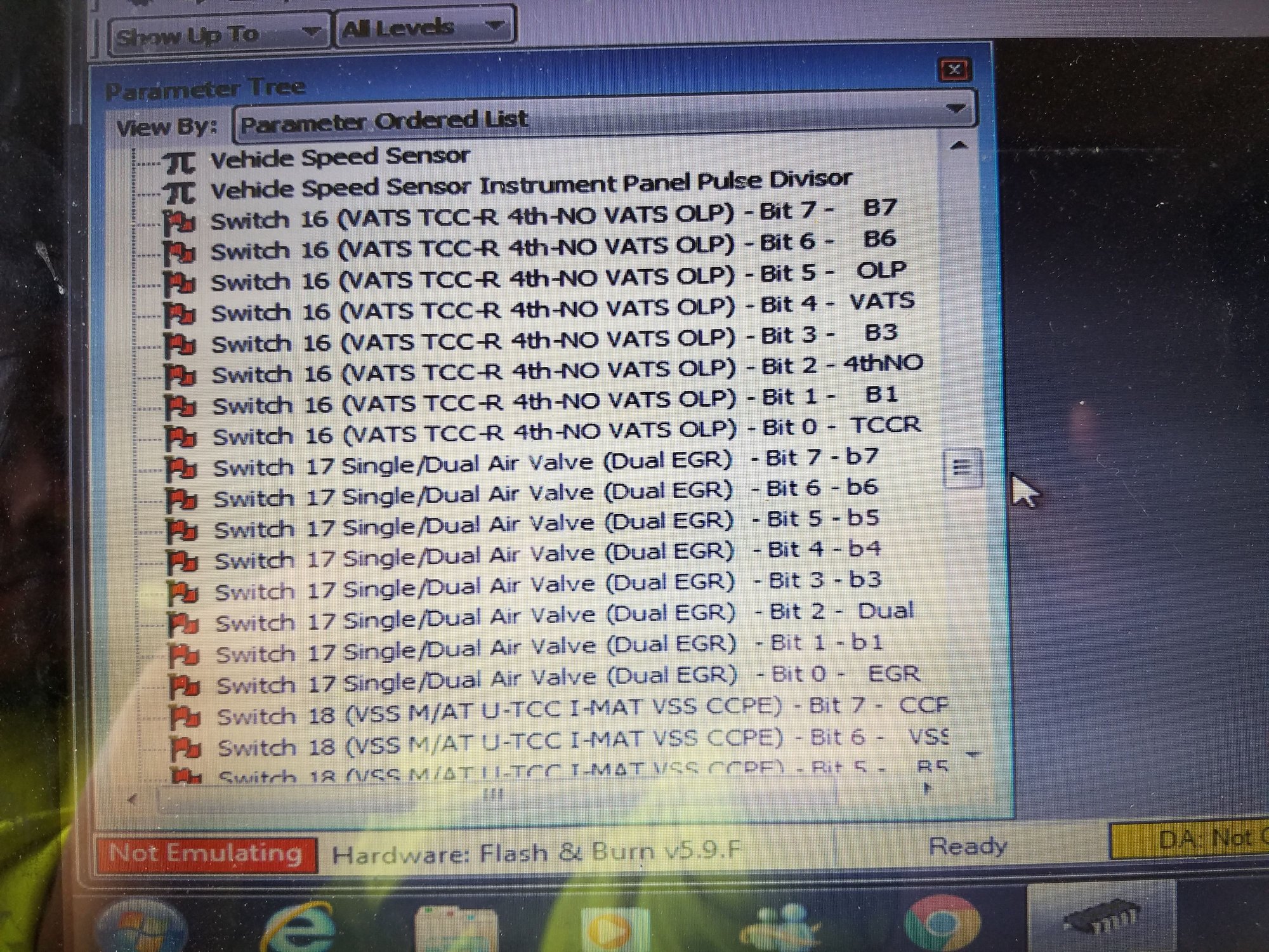

The stock memcal does not have the aujp sticker on it. Maybe they disabled the vats then. That's why they had a yellow wire running directly to the starter and it starts with a switch not the ignition. I'll try to disable the vats. What should I be looking good for? A flag or just disable everything to do with the vats system?

This is all I found on the bin that has to do with vats. And none of them have been set? Is there something good else I should be looking for to delete the vats?

Bingo!!! that was it is disabled the vats and she fires right up!! Awesome thanks guys I appreciate all the help. Sorry for asking so many questions, and frustrating ppl. Now to delete the air system in the bin. Thanks again
