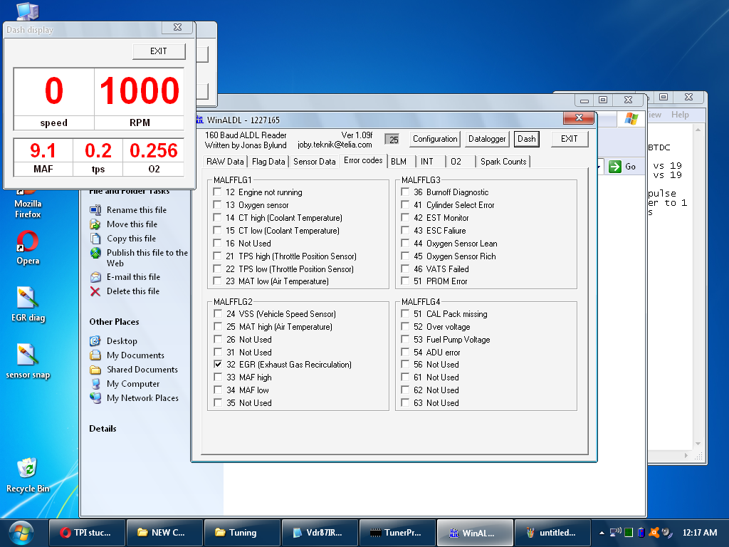

I got Tunerpro and WinALDL running finally on my laptop and after the 3rd start I noticed that the SES check engine light comes on as soon as I start it. I'm also noticing that even after running it at idle for awhile, Tunerpro reports that it's still in open loop and the BLM and INT are locked at 128. The code reported in Tunerpro and winaldl is code 32, the EGR circuit.
So I am thinking that when we screwed the pin back in, we went too far and maybe it's contacting the bimetal element inside and grounding the circuit, triggering the code 32 at startup. I unchecked the flag to disable the code 32 and burned a new chip, it still will not go into closed loop.

As for the Code 32, my friend told me he turned the contact pin all the way in. I removed the plenum (again lol) and check for continuity from the body of the EGR diagnostic temp switch and the middle terminal of the wire. It showed a direct short (grounded). So I backed the contact pin out until it no longer showed continuity (about halfway) and applied some RTV to try to keep it in place. I tried to use a 6-32 nut to hold it in place but that nut wouldn't thread in for some reason.
I buttoned it back up and turned it on and no more code 32. This LT1 cam pulls really hard compared to the peanut cam.
