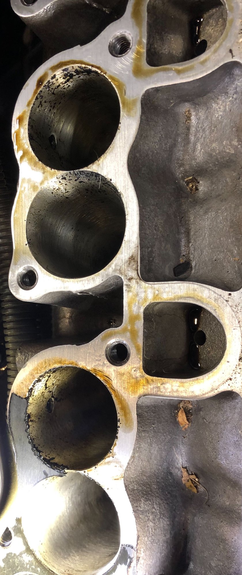

Started to pull plenium. I can see from the gaskets that I have quite a bit of cross contamination between cylinders. Especially the right side, that runs rich. The attachments show both top and bottom of plenum gaskets Left bank is on left side and so on.

The LT-5 architecture uses a plenum sitting atop Injector Housings. So its a bit of a sandwich w gaskets joining the plenum to the Injector Housings, and then the Injector Housings to the cylinder heads. So far, I have found evidence of oil seepage at the plenum mating area, and subsequently the IH interface to the cylinder heads. The cylinder heads also have PCV vents that are adjacent to the cylinder runners which creates a potential for sucking oil into the chambers. Posting pics of gaskets which present evidence of oil contamination of airflow.

Quick update. Cleaned Injector Housings out. Reaching the point of puting top end back together, But first I literally swabbed the valves to removes carbonized crap from some of them. Not sure why some are clean and others have some carbon built up behind valves. Got new gaskets so soon...
