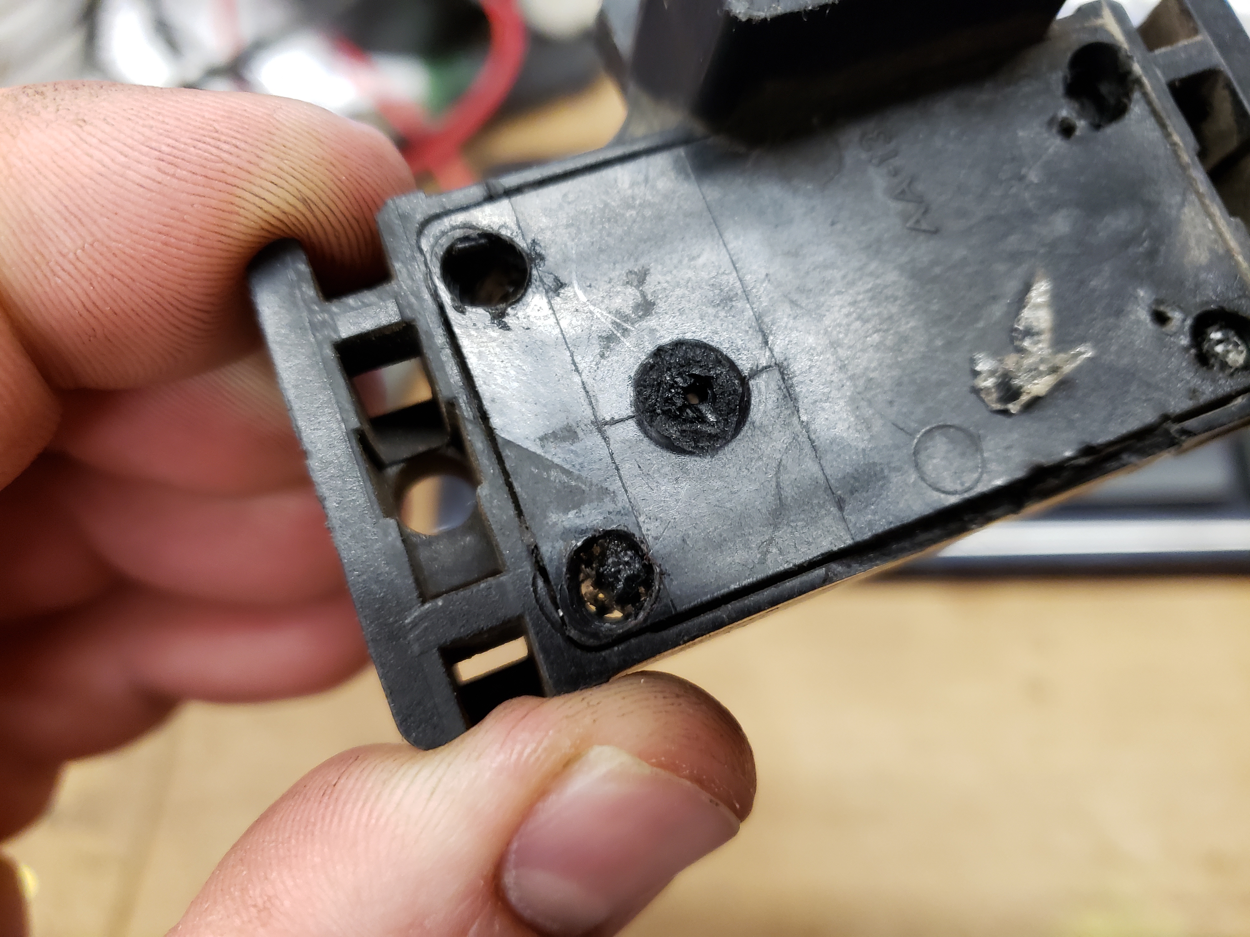

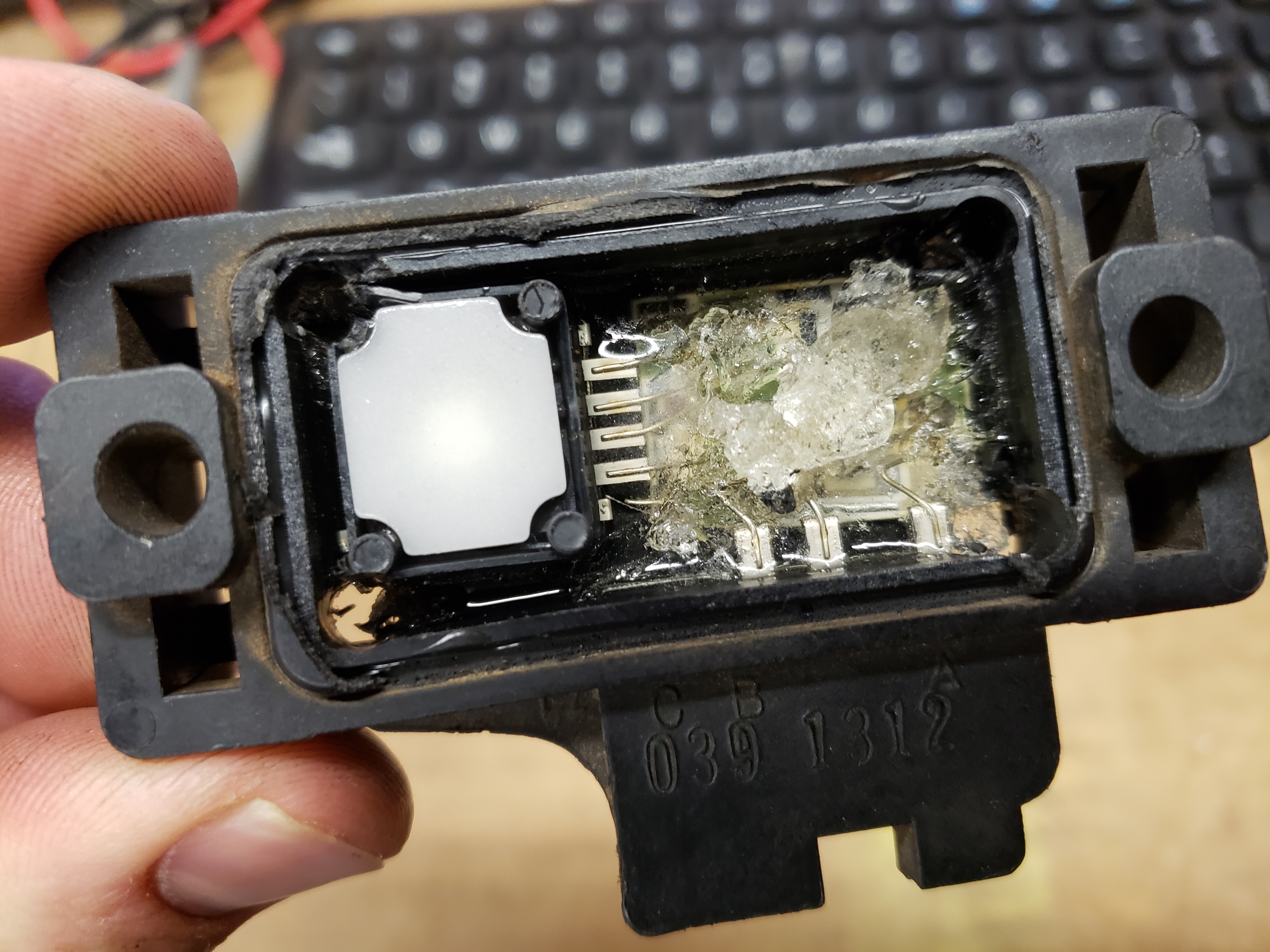

Figure out why the MAP wasn't working. The conformal coating inside was soft as jello. Looks like it even plugged up the hole where the vacuum port is.
