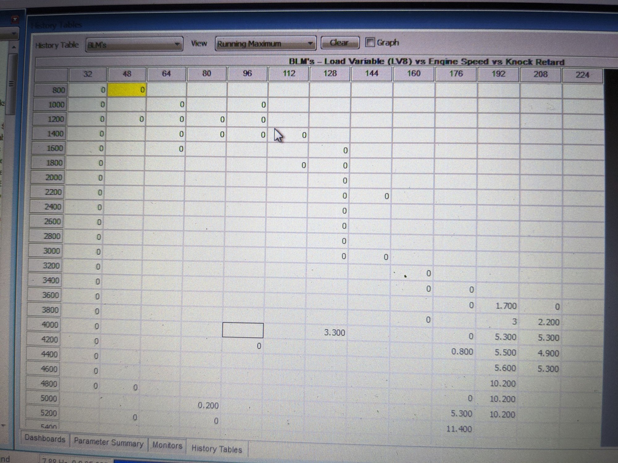

Hello
I finally was able to connect and data-log from my 1989 165 ECM (using APU1). Now I am able to see the data on a dashboard, but I have not been able to make a VE table to graph it. Can any body post a picture of a VE table for a maf car. I would like to see if I can then try to replicate it.
Thanks

Thanks , So for my BLM tables I should use RPM and MAF?

You can set it up a few ways, but a table for blm vs rpm and another with rpm vs maf to see which maf areas your in.
i don’t think you can have three items listed at a time.

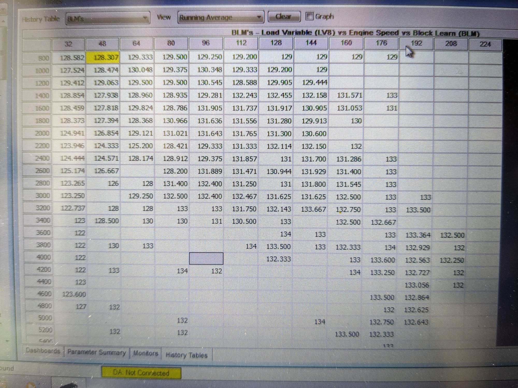

Thanks Tuned performance, I was using the wrong value for the x axis. I am now using RPM for Y axis and LV8 Load for the x axis.

Can someone chime in on the tables below BLM,s history average, maximum and minimum along with a knock retard table. I getting up too 10 deg of retard above 4K rpm. I am assuming the tune is lean and needs more fuel. Is this correct?

You might want to first start to add fuel. 3.29v 102 gps up
maf 4.
