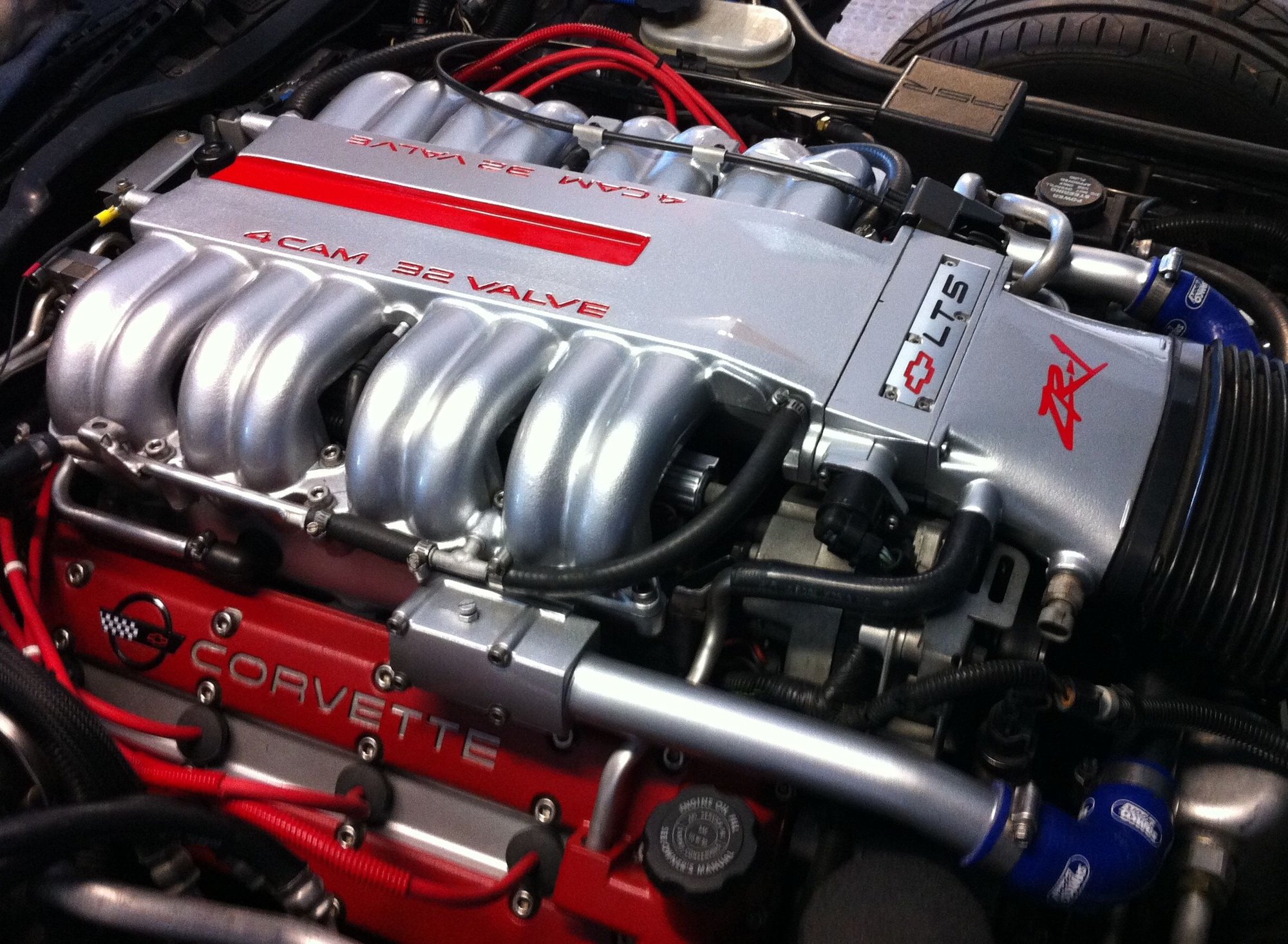

Here you go. Those are Z06 NPP tips. Motor has intake and exhaust cams.
https://youtu.be/muNNY-NQtGc
I loved my DOHC V8s. I have had 4 of them.
