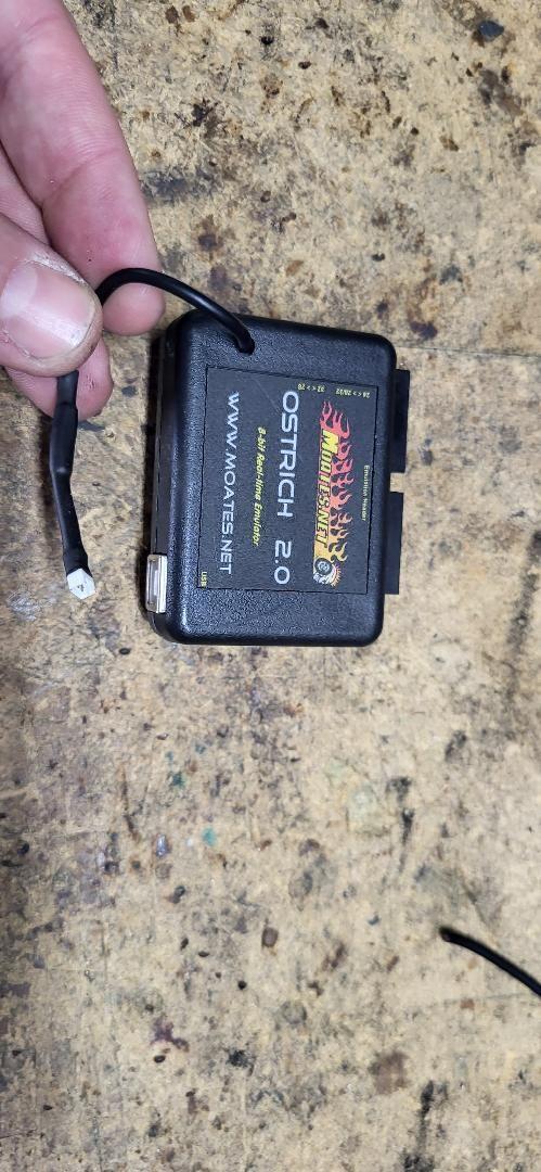

I got stranded the other day. Car shut down while I was driving.... fortunately I was only about 1 mile from home. Also, fortunately I carry around with my a spare ignition module, cap, coil, standard EProm chip, ECM, etc... plus all the needed tools to install them.
I was able (by process of elimination) to determine that the Ostrich is malfunctioning. Soon as I replaced it with the standard EProm, the car fired right up.
The only thing I can think of is that the battery has died. It's been on the car in continuous use for probably 6-7 years now.
I opened it up and the battery appears to be semi-permamently installed. Can't tell if its soldered in, brazed in, gap welded, etc...
Anyone know how to replace these things without damaging the unit?

Sbformula, it doesn't appear to be glued. More like brazed or gap welded or something. BTW, how did you find out the battery needed to be replaced?
I measured the voltage on mine and its reading about 2.7V. The battery has 3V written on it. A new CR032 battery reads 3.2.

I unsoldered the battery from the PCB just now.
This is what it is...
https://www.ebay.com/itm/13442465012...Bk9SR_bi4PCUYg
Sb, I think I'm probably going to do what you did. Get a socket for a CR2032 standard coin cell battery and route wires to the outside of the unit. That way I can easily change the battery easily next time.

Yeah it's the battery. I temporarily wired two AAA batteries together to generate 3V.
Car fired right up.
just ordered a socket off Ebay. Too bad Frys Electronics went out of business. Could have just driven over there and bought one.

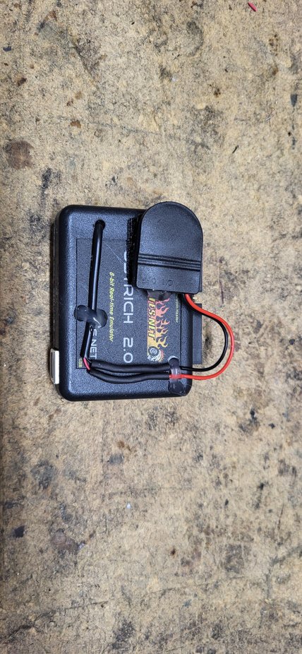

The battery holder is supposed to arrive tomorrow... lol... I ordered from a local seller thinking it'd get here more quickly and it takes freaking the whole week to ship it 35 miles.
Any rate, figured I'd get a head start on soldering. Decided I'd install a connectorized pigtail for future convenience.

After further consideration I decided against the connector. Unnecessary risk of it becoming disconnected while driving. Ended up hard wiring it in.

Mine was doing something similar. It must rely on the battery to maintain the memory.
I guess I'm pulling it out and trying and atleast measure voltage
https://www.ebay.com/itm/295618008416
I can wire the flying leads directly to the PCB.
Can you please post another link for the remote battery holder you used.... This link doesn't work anymore. I finally got my engine running only to findout I'm in LIMP mode and im hoping it's because of a bad battery in my ostrich that's been in the glove box for 15 years. It's always something haha
mine needs a flash every key on or it's in limp mode. might try flashing the same old tune to get it running
Basically just search on cr2032 battery holder and you'll get tons of hits.
