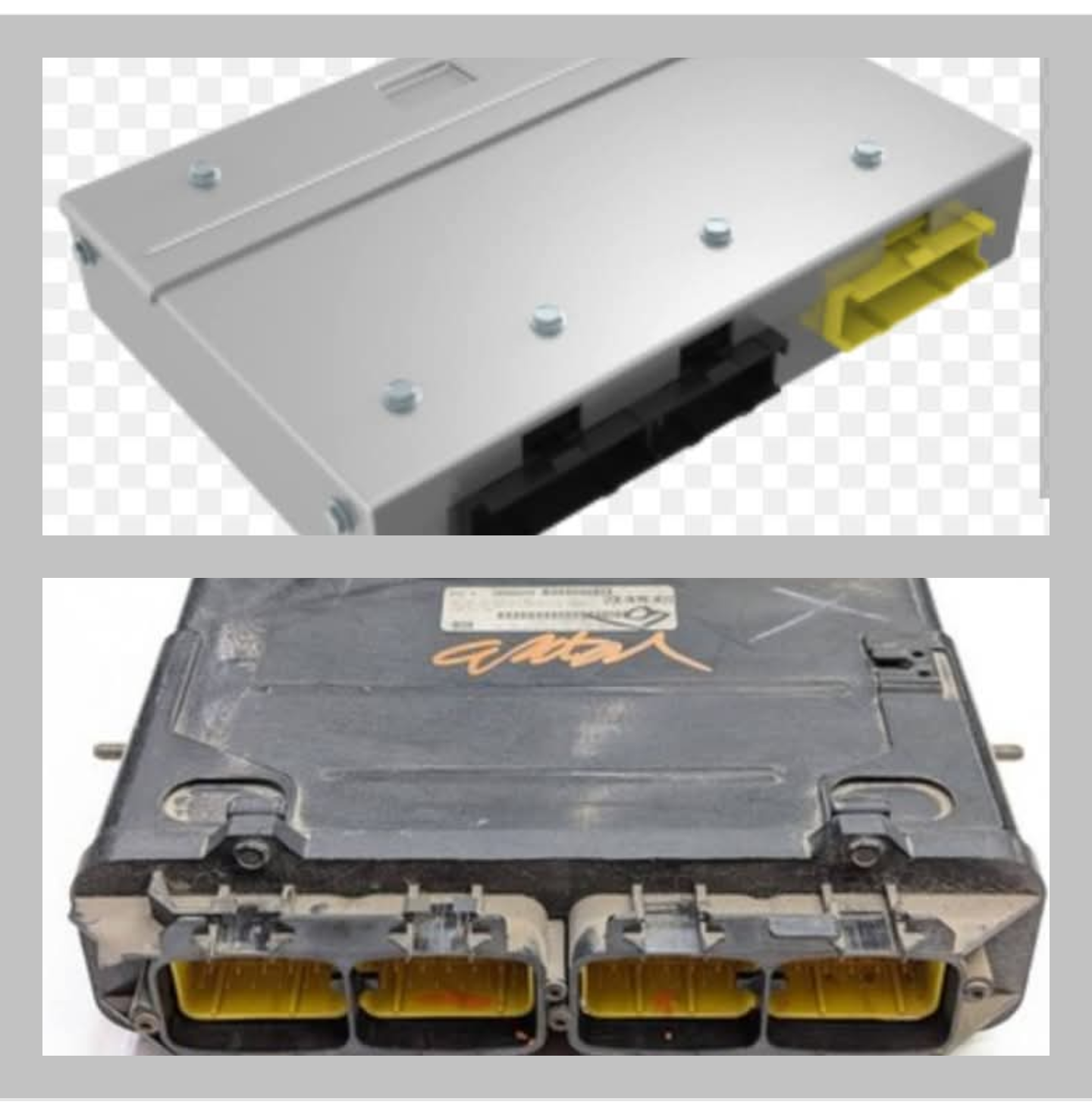

I’m seeing this:
https://www.thirdgen.org/forums/atta...900d1185458709
which tells me the lookup for pin c21 will be identical. Makes sense because as I said, the code is nearly identical anht to axxd.
I got your stuff let’s see how motivated I am.

Exactly what i was told and found.  Top 7730 with 2 connectors, bottom 7727 with 4 connectors.
