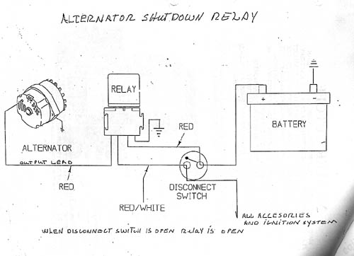

In the end, I rewired my 12v supply to the ECU in front of the switch to kill the engine. That way when the switch is tripped in an emergency, the ECU cuts off the signal to the fuel pumps, injectors, etc.
Alternatively, I robbed this off the internet back in 2001ish...haven't tested it, but give it a try if you'd like.
AWESOME! thanks man! im going to have to sit down and look at that schematic and decide what route to take with the project, but that definitely helps... i like your idea a little better though!
