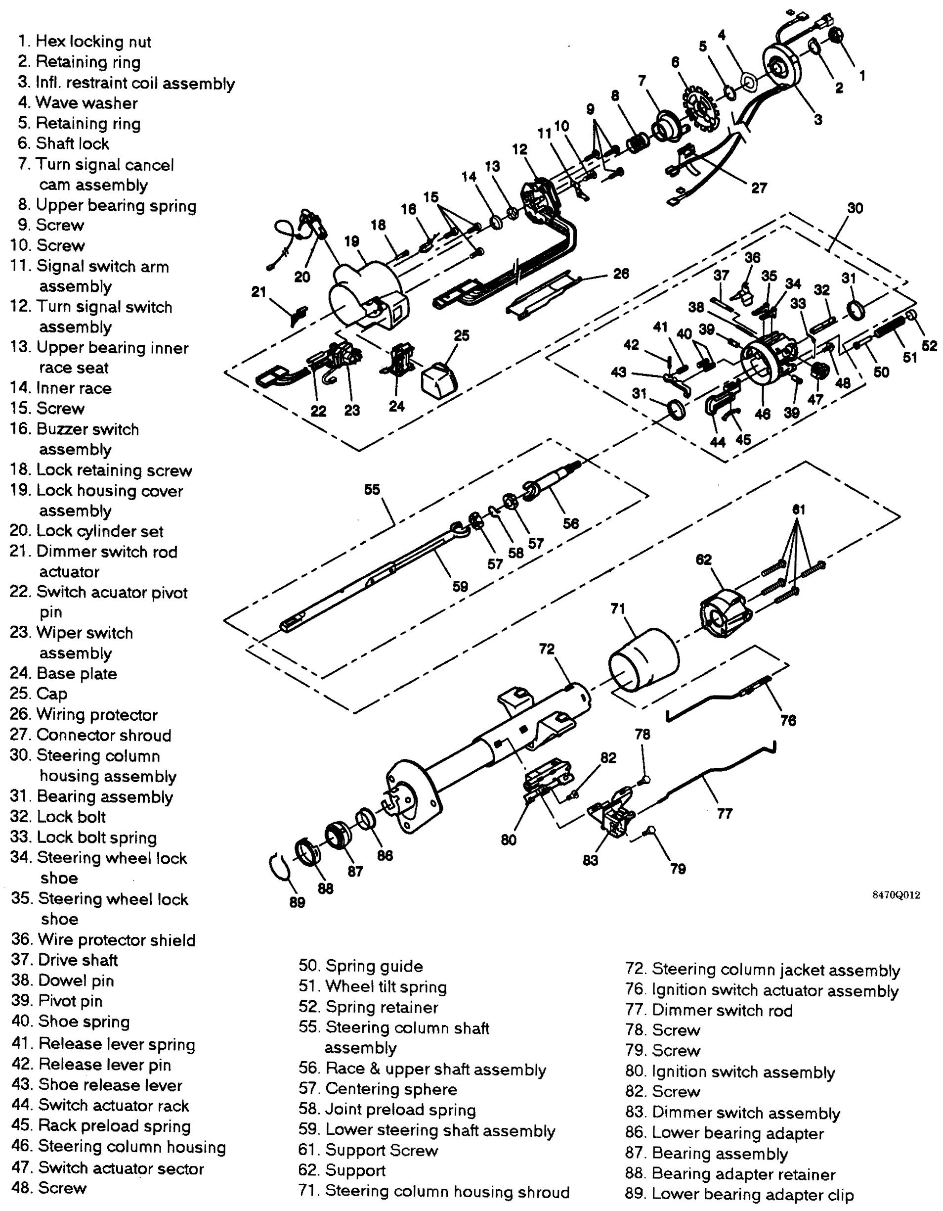

I vote that we adjust the dimmer switch position, since the 15-year old rod actuator is probably just a little worn.
The switch is mounted on top of the outer jacket of the steering column, right in the driver's footwell. Just loosen the screws and slide the switch upward farther, snug the screws and try it. Another way may work if the linkage is only slightly worn - lower the tilt column to it's lowest position and try to dim the lights again. If the switch operates then (listen for the "click"), your linkage needs adjustment. The lowest position seems to help take up some of the slack in the mechanism.
The drawing shows the location. Look at items 77 and 83:
