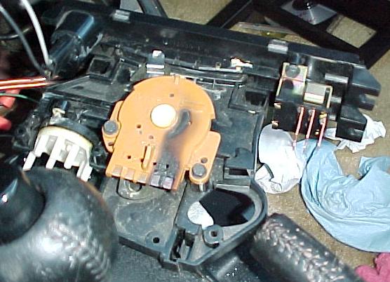

Anyways, when I purchased the car, I noticed that at night the HVAC controls are pitch black. I'm not sure if the bulb behind them has burnt out, or if there even IS a bulb behind them to illuminate them. If there is however, how do I get at it, and what type/size is it?

Welcome to the boards first of all. Yes it does have a bulb back there. You will need to remove the trim around the radio and the heater controls. Remove the screws or bolts holding in the controls..the bulb should be right there in plain sight. I beleive it is a #194 bulb if I remember right. Get it out first and go from there. HTH ( Hope this helps )

Yes ther is a bulb, do what Kaz said to get to it. Heres what it looks like, its the black and grey plug in the upper left of the pic.
I borrowed it from the other post, just thought it might help. Thanx ctandc.
