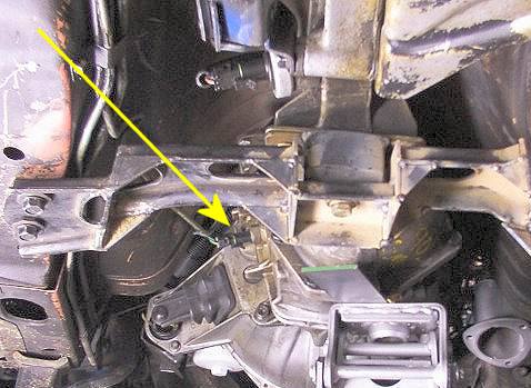

cris.. a T5 tranny (standard shift) has no wiring on the shifter. Taking apart your console will net you no progress to your problem unless you have an automatic.
reverse switch is located here...

well i had the consol out because im wireing power windows and locks and puttng the controls on the consol, so it wasnt a big deal that i had it out- now i know exactly where your talking about, i was looking at that asking my boss what that switch was with those wires running to it last week when we had the car on the lift, my tranny was making noise and we found out it wasbecause the guy who changed the clutch befor i had it only put 2 bolts back on and didnt tighten them- 2 bolts and an hour later it was running great, well thanks for your help- ill go to the shop tomorrow and see what i can do about that switch
