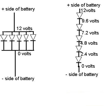

here is a diagram of something similar of what i want to do, which one is how i wire the Resistors in?
PS i bought about 10 1/2 watt 15Ohm resistors, will those be ok?

actually danno i think that much resistence is too much, the two 15ohm resistors i wired up Acc. to my old physics teacher should work fine, i did it like this...
Joined: Aug 2001
Posts: 1,896
From: Warrington, PA USA
Car: "02 z-28
Engine: LS-1
If the diodes are all in series 15 ohms is probably OK. Your drawing shows a common positive and negative bus meaning the diodes are all in parallel, perhaps my mistake. However if they are in parallel 15 ohms is too low. Using I=E/R, in a parallel circuit each diode in the circuit would have to dissipate .8 amps or 800 ma. Way too much. I based my opinion on the right side of your drawing, it does not show a connection indicating a series wired circuit. Rule of thumb for most generic LED's using 5 volt source your current limiting resistor should be approx. 150 ohms, using 12 volt source anywhere from 270-390 ohms. These values are approximate but should work well in most applications. Depending on your circuit don't forget to calculate the power dissipation of the resistor.

I tested the lightbar today on a 9volt and the resitors got pretty hot, so i am worried if i put the 12volts through it may burn out the resistors..
12volts----LED---LED---LED---ground This is in series
..............I--LED--I
12 volts --I--LED--I---ground --- this is in paralell
In series each LED drops a little of the voltage, so they all share the same 12 volts
In paralell they all get a full 12 volts and this draws a lot more current

Ok got it, i knew that much, my question is will the two 15ohm resistors be alright, is them getting very hot with a 9 volt a problem?

After reading that link that backinblack posted i see things a bit easier but i have a question...
his equation was:
LED Drive Current(mA) * Supply Voltage = Resistor wattage.
my question is what if ther eis multiple LEDs is the equation constant or does it change to:
n(Led Drive Current(mA) * Supply Voltage = Resistor wattage
where n = the number of Leds.
his equation was:
