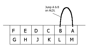

The SES light with the key in 'run' (but engine not running) position is normal.
As far as code retrieval (code 12 is normal as well)....

i think its a to b, ..but some were A to M for some reason...i forgot what year that was on ...im not much help here....but the light is supposed to come on, and when you chekc the trouble codes , its supposed to have one long bling...pause.. the n two short blink....three times in a row....then after that, the trouble codes should blink
