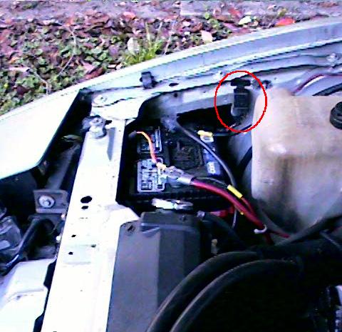

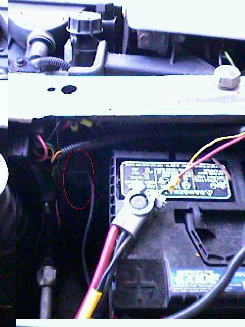

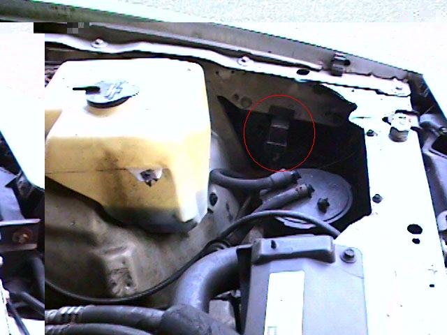

All three relays look the same. On my 86, two were mounted on the inner fender, near the top,
behind the battery(pass. side)/cruise(driver's side) tray. The third one was mounted next to the
radiator, in front of the battery.
As I said, they all look alike, but I don't recall if they all have the same p/n.
-Jeff
Edit: I went and checked, and they're not all the same. Two of them are (the ones on the fenders) but,
the one on the radiator support is a little different. I took some pics, but my good camera is at work.
So, you'll have excuse the quality.
-Jeff

First, the driver's side...

Passenger side...

And the last one. The numbers I found on 'em were 1003124 (for the two on the fenders) and
14078915 for the one pictured here.
