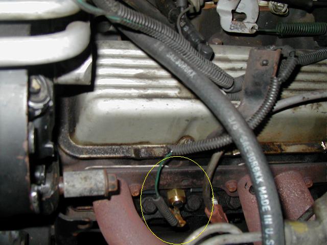

heres a pic of my car, i believe thats the guage sender in the head right next to the spark plug. i numped mine off while putting in headers and had to tape it up alittle.

OK, Here is a pic of the temp sender. It is looks like a large nut with a wire connector on top. It should have a green wire connected to it.

Thanks for all of your help guys. Turns out that the temp sensor that was originally on the driver's side of the head was knocked off by some idiot who decided not to take the time and replace it, but rather leave it in there and put a new one on the passenger side of the head between the 6 and 8 plug. The only thing that was throwing me for a loop was how odd it looked. It didn't seem like the connector would match up to it, but sure enough it did. I did just knock off the wire when I was changing out plug wires. Once again thanks for all of your help!
