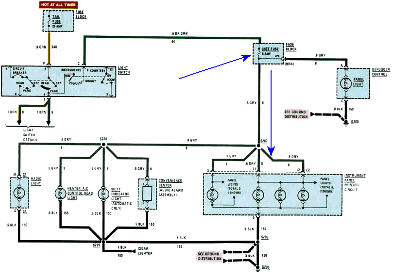

I realize initial power comes from the tail fuse but, if your parking lights (not just the tail lamps) are not working along with your gages, yea, it's probably the tail fuse. If the gage lights only are out/not working, they have their own fuse that can blow. If the fuses are good, there is a problem in the circuit to the gage lights or, the rheostat (dimmer control) in the light switch has finally burnt up, which isn't too uncommon.
